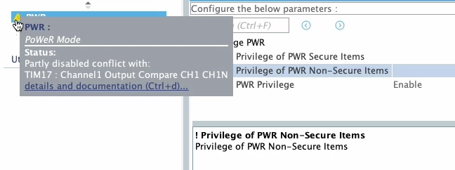

KMill
Senior
January 23, 2024
Double check the settings for PWR Mode in the MX configurator (the IOC file).
hguanAuthor
January 23, 2024
Hi KMill,
Agree with you. It is a hardware design issue. By checking the schematics, the PB7 in fact is connected to a resistor. Will start a new revision of the schematics shortly.
Appreciate your help.
