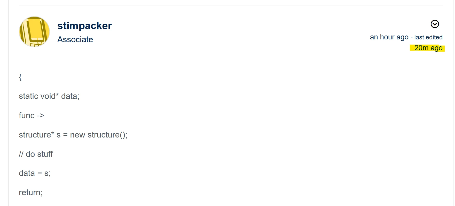

October 8, 2024
static void* data;
func ->
structure* s = new structure();
// do stuff
return;
Callback ->
structure* s = (structure*) data;
// Error
The local "s" variable in the function has no relation to the local "s" variable in the callback. The global "data" variable isn't accessed anywhere in the function.
It's unclear what result you're looking for here, but the code doesn't do anything useful.
The GCC compiler is robust, it's unlikely the be the culprit. More likely a bug in the code.

October 8, 2024
> Sorry you feel like it doesnt do anything. But like I said, it works fine for the rest of my code
You have silently edited your post, so yes it does something different than when you originally posted it and when I made my comment.
data should be declared volatile, since it is used in the main thread and a callback, but probably not the issue.
The takeaway is the same: it's a code bug, not a compiler bug.
If something is being modified and you don't know where or why, create a hardware watchpoint which will break when the memory is modified. This will let you see exactly where it gets modified. Could be a stack overflow, could be issues with memory allocation (two variables with the same location), could be out of bounds write.
