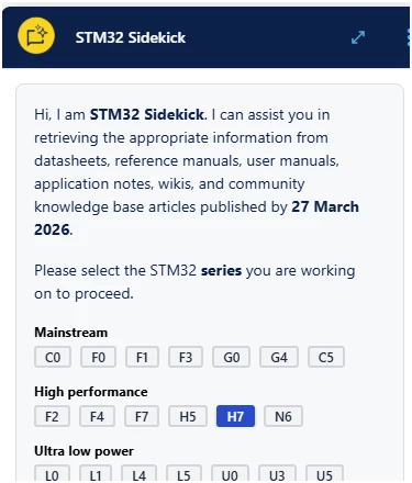

Pavel A.
April 17, 2026
@kamaldevkr while waiting for more useful replies - you can chat with the ST AI about any details of STM32H7. Click on this icon at the right bottom side and select "H7".
