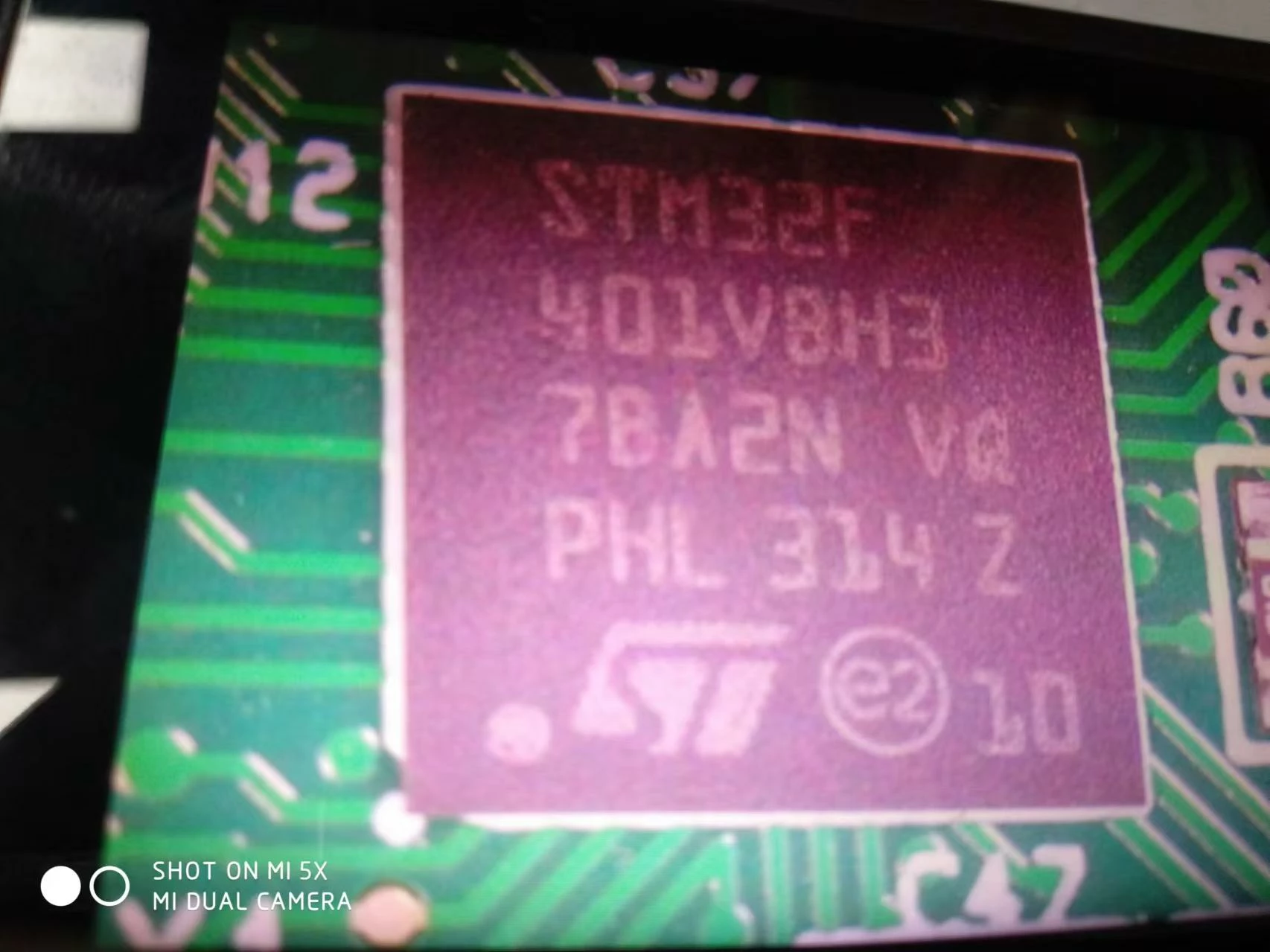

We purchased 403pcs MCUs (STM32F401VBH3) with date code 314 from Mouser website, as shown in the picture below, they have been assembled on the board,

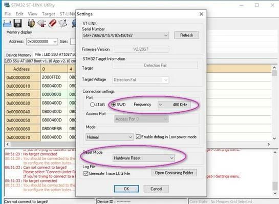

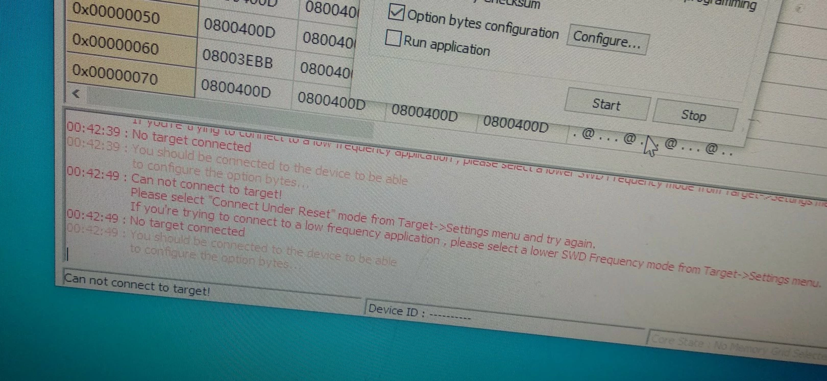

When preparing to program them with ST-LINK utility and the programmer (ST-LINK/V2), I found that most of the MCUs could not be connected, and the utility interface said "Cannot connect Target", as shown below.

I also tried to use “Connect under reset ” and select “ lower SWD frequency mode ” , as shown below, but the connect still failed and still showed “Cannot connect to target ”

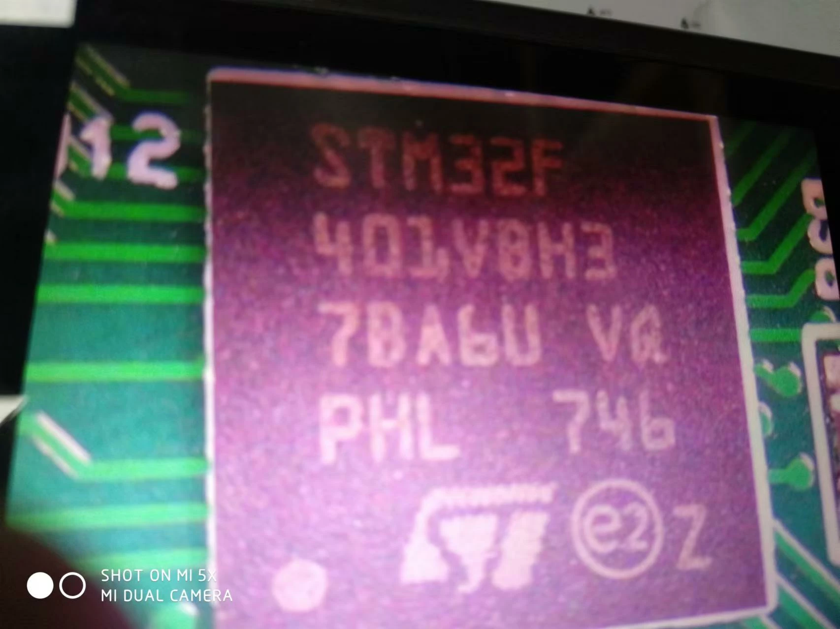

However, we also have 98pcs MCUs (STM32F401VBH3) with date code 746, as shown in the picture below, they are also assembled on the same board, they can be successfully connected and can be successfully programmed.

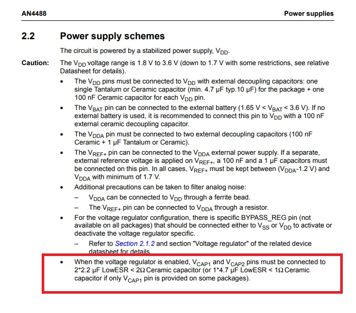

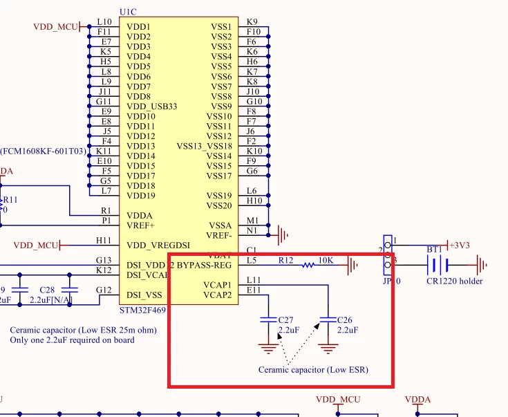

Is it a board you have designed? you need first to check your HW/Schematics:
Especially the VCAP capacitors:

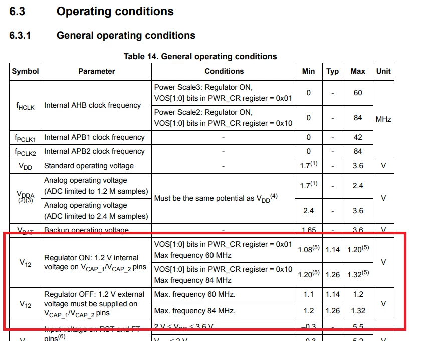

Check the V12 voltage level:
You should have V12 voltage in the range indicated in the table from the datasheet. And check if it's stable voltage and not presenting any glitch during the power-up and reset.
Check also the decoupling capacitors.
Please refer to the AN4488 "Getting started with STM32F4xxxx MCU hardware development"
PS: STLINK utility is an old tool. I recommend you to use STM32CubeProgrammer tool instead.

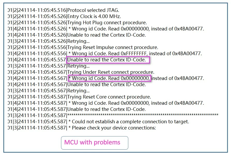

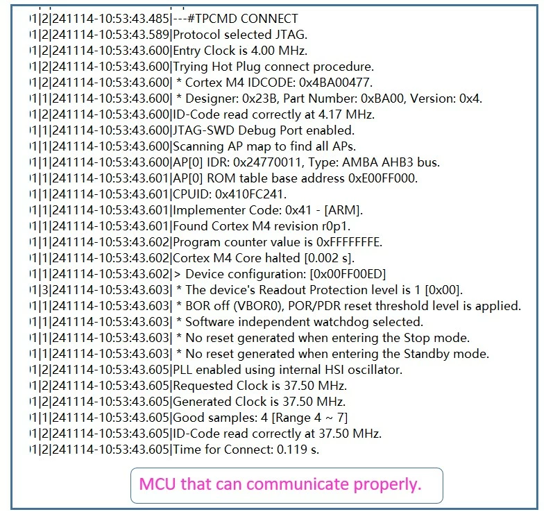

4. In the tool, I observed the reports for the "good" MCU and "faulty" MCU during the connection process respectively, and the results are shown in the figure below.
The ID code of the faulty MCU cannot be read, which should be the root cause of the problem.
Please help analyze the faulty MCU from this aspect.
