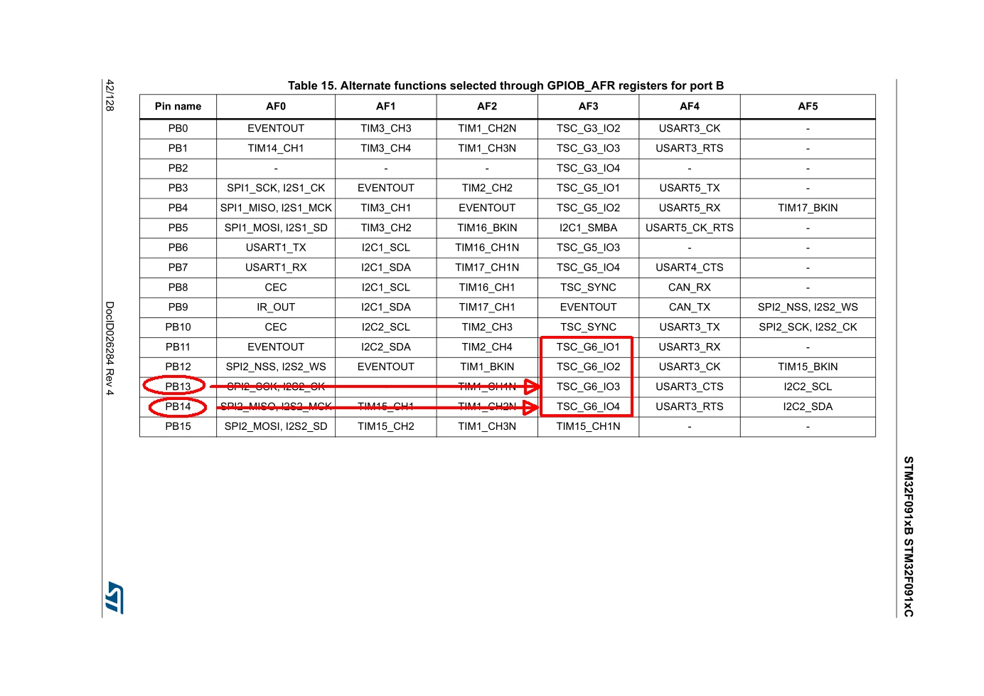

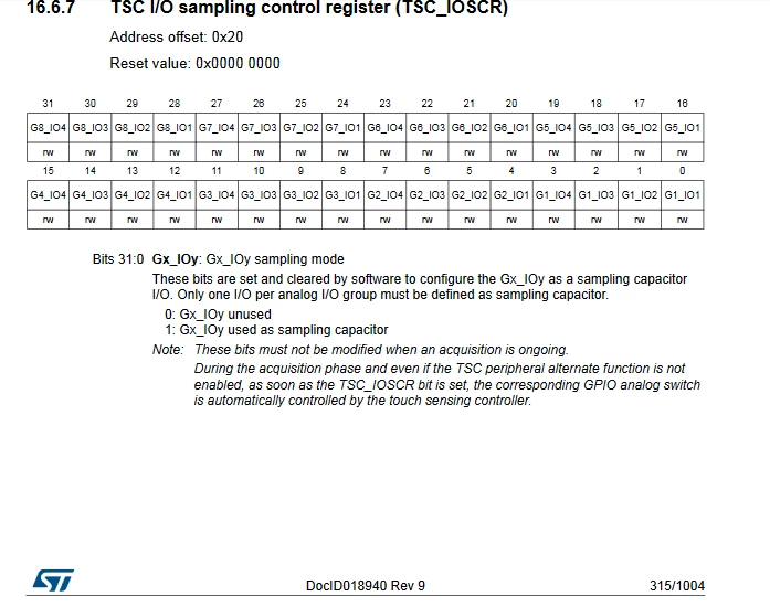

how are capsense pins defined, e.g. TSC_GROUP4_IO1 does not correlate.
also any links to capsense info beyond AN4310 would be appreciated
