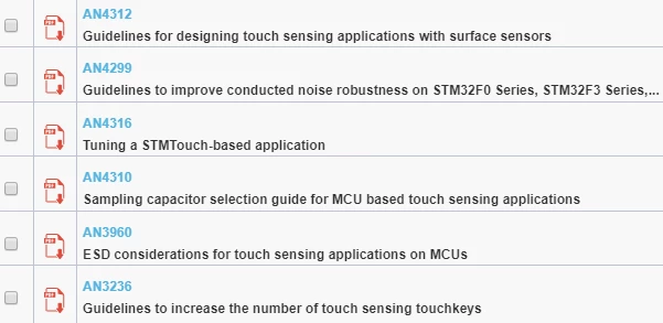

    For touch sensing application a full understanding of the charge transfer principle is essential.
    Additionally, the PCB layout is crucial for these applications.
    Therefore you should read thoroughly the following application notes (in addition to relevant chapters in datasheet and reference manual):
    It is extremely challenging to implement touch sensing functionality on MCUs without touch sensing controller peripheral (full software solution) and achieve good performance and reliability.
