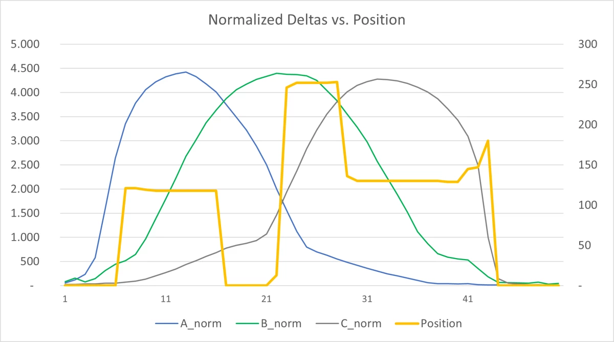

I am trying to get a linear slider (capacitive touch) to work on the STM32F373. The Delta values for the individual electrodes make sense, but the position calculated by the TSL library does not. Please see the details and attached chart.
Using a three-segment linear slider, full electrodes (no half ends); I have chosen the M1 Basic type. I am using HAL, TSL, and the STM32CubeIDE code generator. Normalization of the Delta values is turned on, and I have determined suitable correction factors.
(a) The Delta values for the three electrodes look plausible when I scan my finger over the sensor -- see the three thin lines in the attached plot. But are they expected to be in the 1000s of counts? (Why can I only specify a detection threshold from 0..255 in the TSL parameters?!)
(b) The Position which TSL calclulates from these is total nonsense -- see the fat orange line in the plot. Note how the "position" flips just at the crossover points where another segment signal becomes the strongest one. What is up with this readout?! Am I reading the wrong variable? Is some critical parameter missing?
Thank you for you help!

Just a quick follow-up on my earlier post. I have been digging into the TSL source code for reading linear sliders, and it seems to me that the code is broken by design. It is meant to support sliders with many elements, identify the elements with the strongest signals, and interpolate the position between them. But the interpolation code seems messed up.
For the simple three-element slider I use, I have written my own position calculation based on the Delta values for the three segments. If the Deltas are d0, d1, d2, simply calculating (d2-d0)/(d0+d1+d2) gives a position between -1 and +1 with reasonable linearity.

Thank you, Stassen. I will try to figure out the differences, but am not quite sure yet how to approach that. I don't have a Discovery Kit, hence cannot debug at runtime. And I have stared at TSL source code long enough...
Any idea why my Delta values might be so high -- 2000 to 6000 counts when the sensors are touched? That seems like the first thing that is off; the libraries (and the detection thresholds I can set in MX Cube) seem to assume a range of 0..255.
