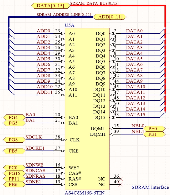

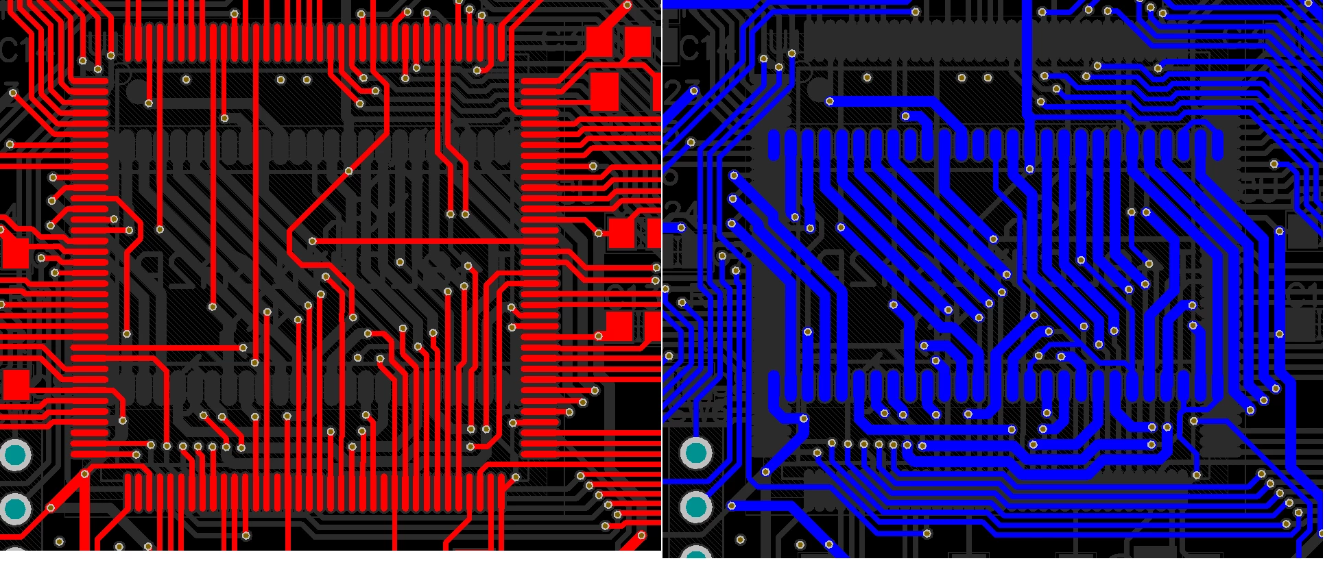

Cant read/write from external sdram stm32f429, AS4C8M16S-6TIN

    Hi JW,
    good gues, O thought it too. But then blocks of memory would be unredable, because address line is used to send colum and row adress so blocks of memory (4x4 cels) would be the same. Now only repetition 1x4 is the same. To be sure now I ***** signals with oscilloscope. You can see in attach I add A0 compare A1 address line and A1 compare A3 address line. As you can see, everything is fine. Also you can find attach 3, where i higlight adress lines from 0 to
    Today I did one more reseach.
    I noticed that if i continously write/read in SDRAM, sometimes I get values diferent than repeation of 4.
    So write my array
    write[100]and after that I read that array
    read[100]. After read/write i compare these two array and if they not match, I stop writing, and left only reading part.

    Your SDRAM lacks of sufficient power supply. 100nF capacitors to every VDD and VDDQ pin is necessary, HF Separation of VDD and VDDQ is strongly recommended. To make it even worse in your design, the SDRAM is sharing its 100nF Capacitory with the uC. See the Datasheet of the SDRAM, it draws 200mA during refresh cycle / 120mA in normal use. See attached file to see more Details ...

    See also attached schematics of STM32F4/7 Disco SDRAM with extra 100nF Capacitors for every VDD/VDDQ pin.

    I try to connect 100 nF capacitors on each VDD and VDDQ pin (see in attatch). There is no shorts i tested all posible shorts with multimeter. But the result is the same.
    Any more ideas, why this bug is appearing?
