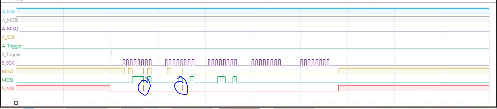

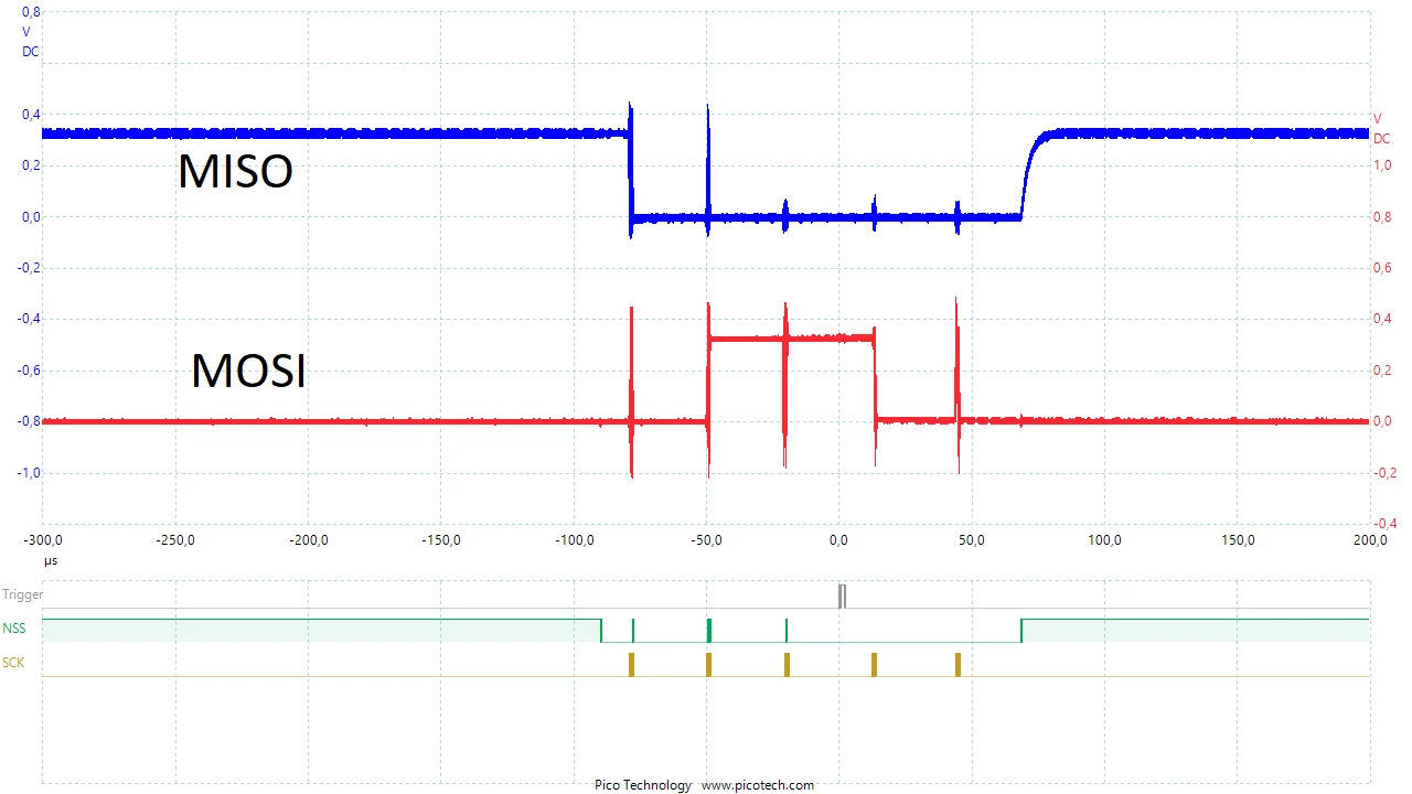

Aug 14, 2020 9:59 PM UTC
Send a dummy byte prior to pulling CS low.
A logic analyzer would tell you what's going on pretty quickly. Hard to do hardware development without one.
MSimo.1
MSimo.1Author
Aug 15, 2020 11:19 AM UTC
Adding one (or two) dummy transmits did not change anything..
i Should make clear, that iam rading the register in the wile(1) loop. So it gets read every 3 secs.
The result of the first time (after the Controller boots) has a different result than the other .. i dont know if thats important..
the Output is :
STM32 Reset
Reset device
data= 17 = 0x11
Reset device
data= 81 = 0x51
Reset device
data= 81 = 0x51 ....

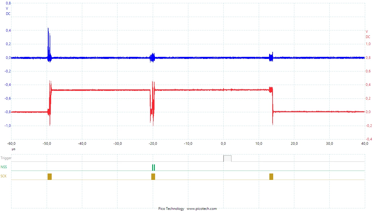

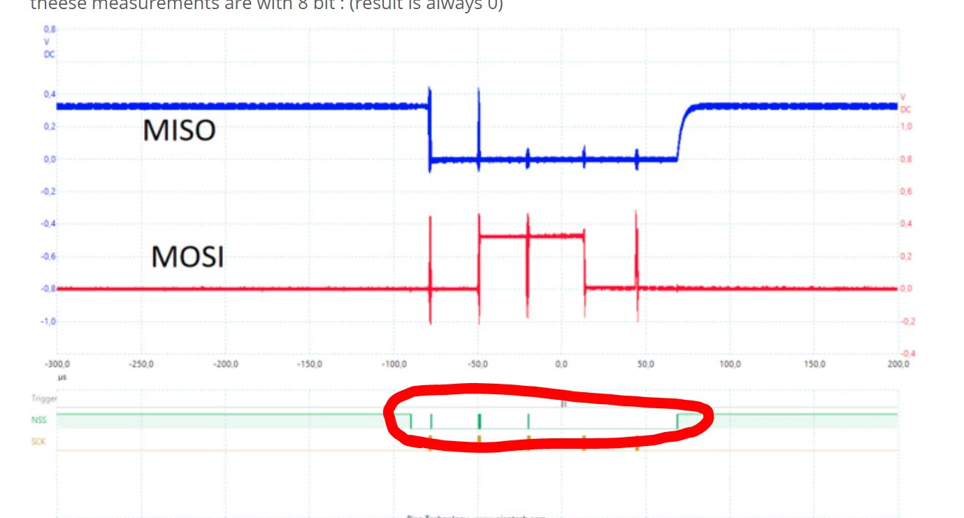

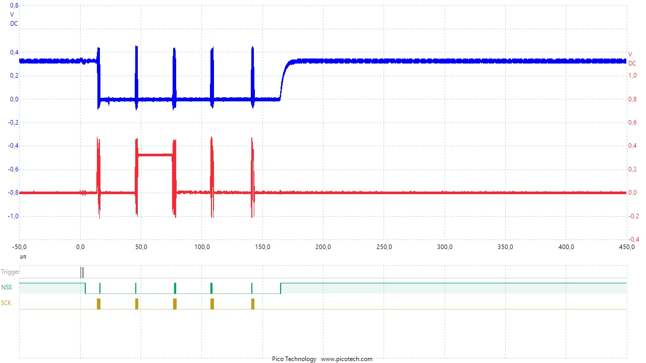

i just hooked my Oscilloscope to the SPI lines .. the voltage levels on MISO seem to drop if i change SPI_DATASIZE_16BIT; to 8 BIT .. why is that?
theese measurements are with 8 bit : (result is always 0)

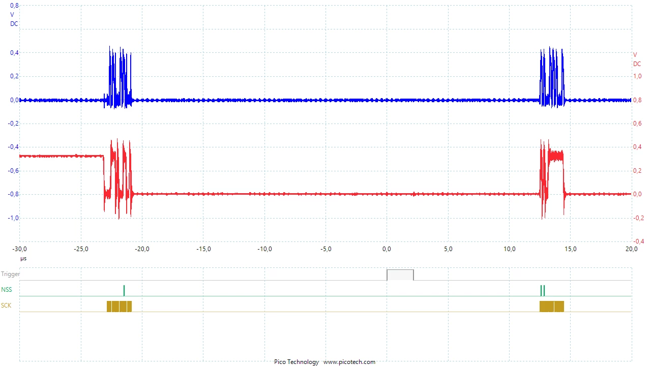

the next 2 pictures is with the same code, but the Data_length changed to 16 (wich gives me wrong results (bit not 0)):
i hope this helps ..
Aug 15, 2020 2:10 PM UTC
Your scope is suggesting the voltage level is ~0.33V. Are you using probes in 1x mode instead of 10x mode?
Why are you using SPI_DATASIZE_16BIT at all? If you want to send 8 bits per transaction, use 8 bits per transaction.
Your NSS line is toggling mid-transaction. That's no good. Could be noise.
In any case, you're going to need to zoom in on MOSI/SCK closer to see values of individual bits. If those bits are correct, then the STM32 code is not the problem and there is some other reason the IC is not responding correctly.

Aug 15, 2020 6:06 PM UTC
Yes, my probe is a 10:1.
My result (from the register read) were always 0x00 when i had it at 8 Bit. This was the reason i changed it to 16 bit. I know its nonsence, but i was happy to get any data (wich is wrong, but ar least there is something..)
Picture 1 and 3 are zoomed out. you can see the 5 Transmits iam doing in my code. thats th reason NSS is pulled high 5 Times (after each transmission)
Iam still wondering about the voltage levels in Picture 1 and 3 . The blue spikes are much smaller after i switched it back to 16Bit DataLength ..? no clue
Picture 2 and 4 are zoomed in. You can see the transmission before and after the trigger pulse .. the first one is from HAL_SPI_Transmit(&hspi1, &addr_l,1, HAL_MAX_DELAY); and the second one from HAL_SPI_Transmit(&hspi1, &term,1, HAL_MAX_DELAY);

RMcCa
Senior II
Aug 15, 2020 6:25 PM UTC
Not sure what the problem is exactly but it doesn't look like the nss line is being handled properly. Is it toggleing​ during the transmission?

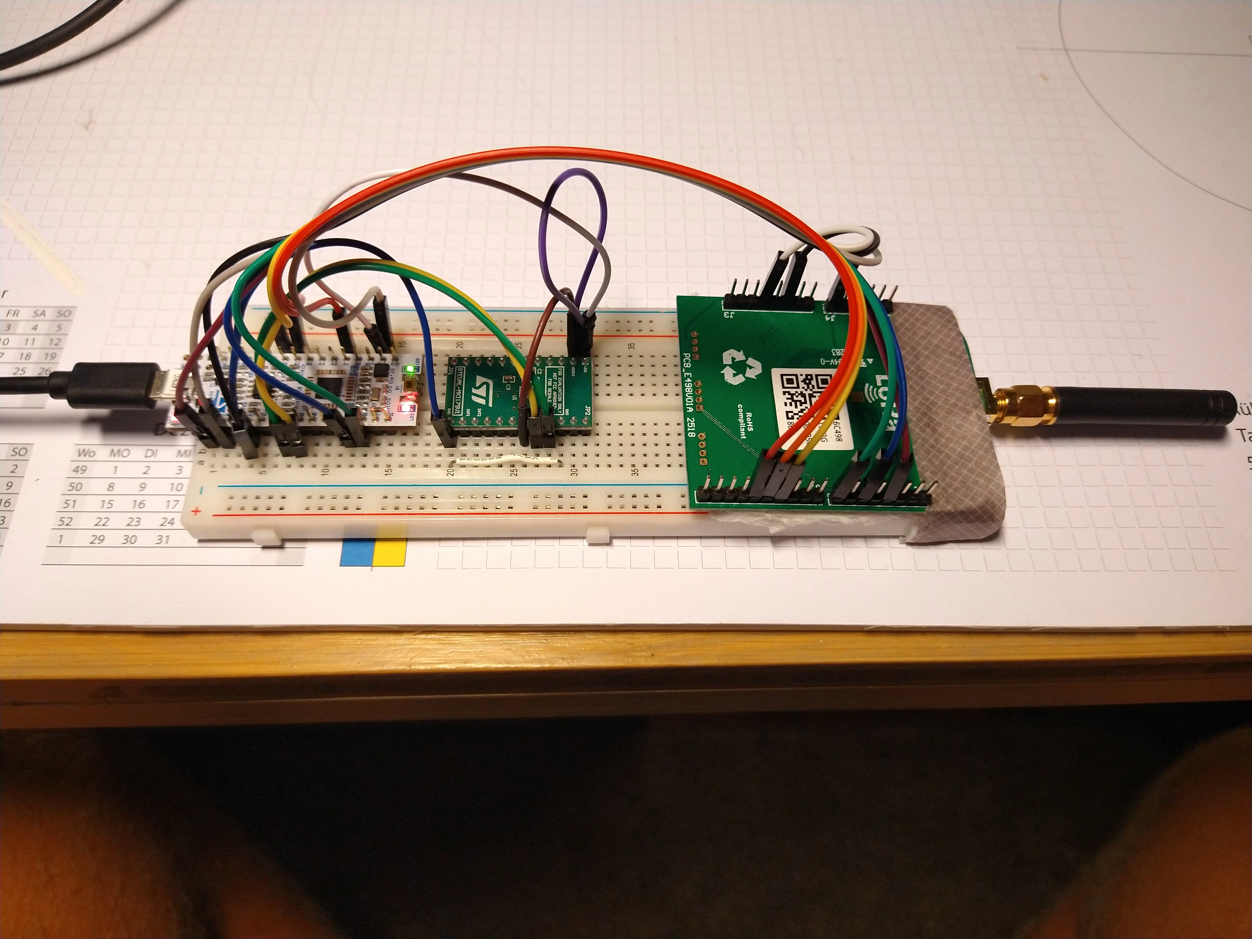

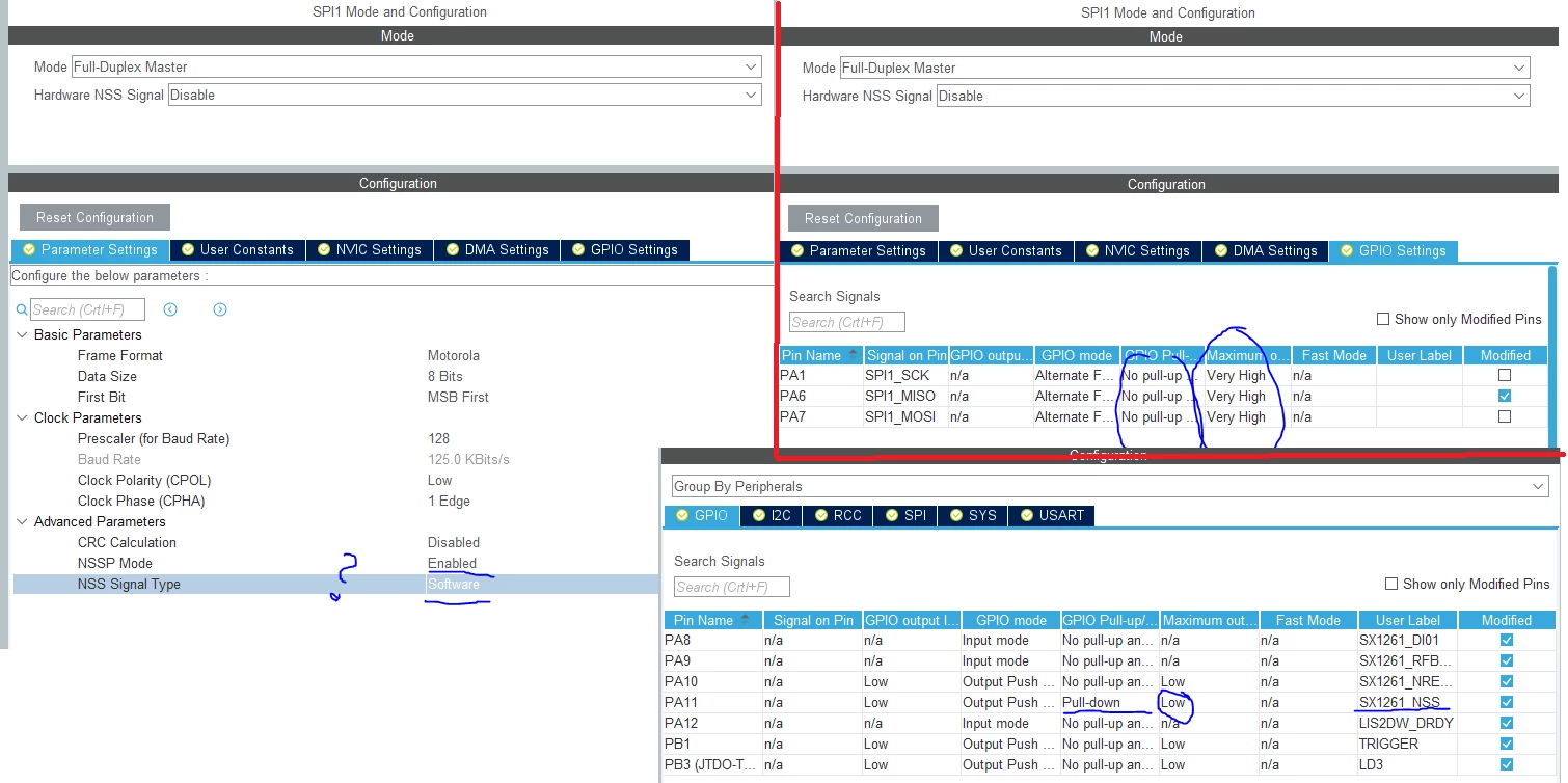

alright, looks like i found the problem : 0693W000003PUiZQAW.pngis that a typical "breadboard" problem ? my project looks like that:0693W000003PUioQAG.jpgHow should i handle my NSS ? Can it be controlled by the HAL driver?
I tried to lower the Frequency and a PullDown at my NSS GPIO..
0693W000003PUkpQAG.pngshould i change something here ?
the GPIOs have a optoion called Max output frequency .. are that configurable low passes ? should i use that ?
Or Should i just solder my circuit onto a perfboard and get rid of this breadboard?
Thank you guys!
Aug 17, 2020 7:06 PM UTC
That’s literally the same thing I circled in my response two days ago.
Control the CS pin manually as a GPIO output.
