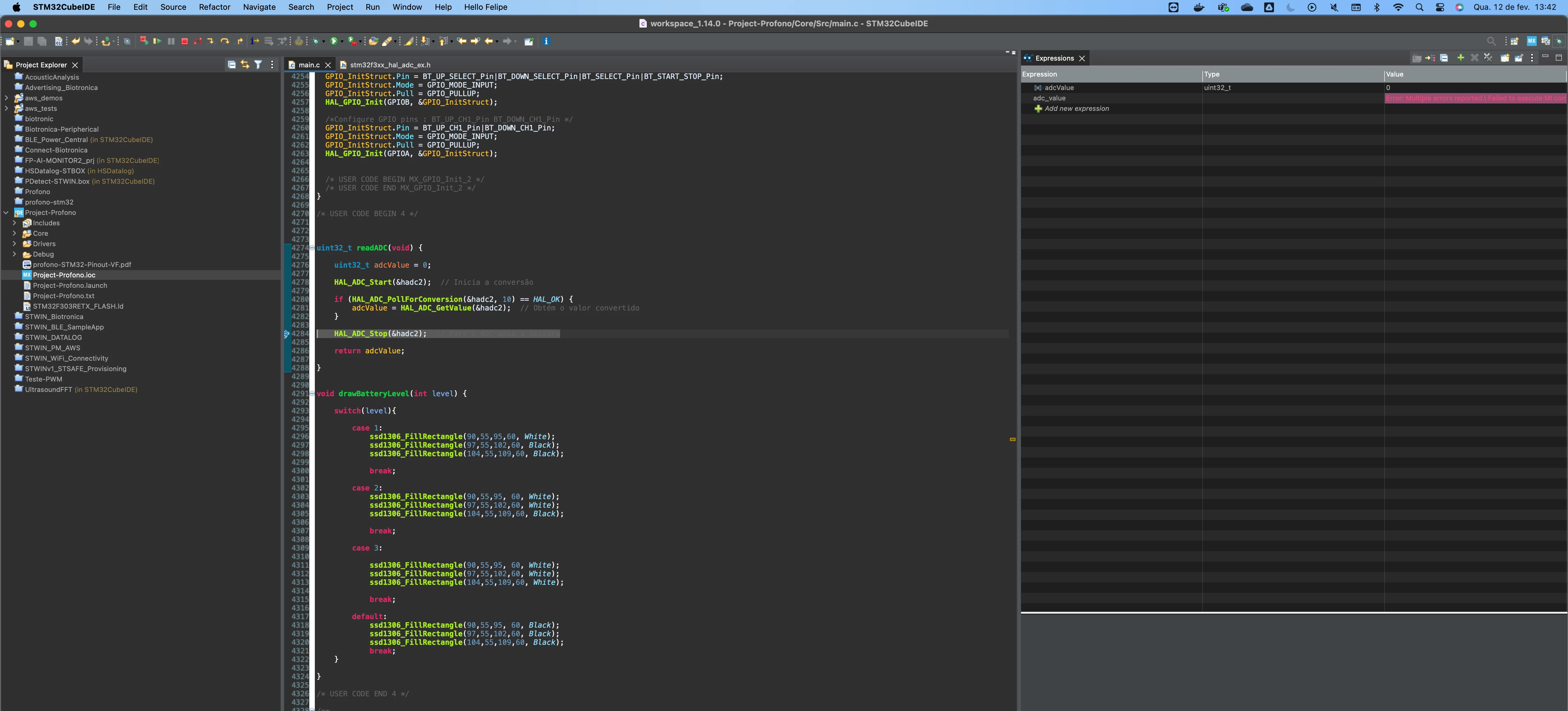

I have a project that already uses pins PA4 and PA5 with the DAC, but I cannot obtain a value when using pin PA6 to read a voltage level

Need to explain what do you mean by "I cannot obtain a value when using pin PA6 to read a voltage level"?
Always 0? constant value? else?
Need to attach your project so others can help you efficiently.
February 12, 2025
Always 0
I don't know if I'm configuring something wrong
mƎALLEm
February 12, 2025
You need to share your code ..

February 12, 2025
uint32_t readADC(void) {
uint32_t adcValue = 0;
HAL_ADC_Start(&hadc2); // Inicia a conversão
// if (HAL_ADC_PollForConversion(&hadc2, 10) == HAL_OK) {
// adcValue = HAL_ADC_GetValue(&hadc2); // Obtém o valor convertido
HAL_ADC_Stop(&hadc2); // Para o ADC após a leitura
return adcValue;
mƎALLEm
February 12, 2025
return adcValue;
You need also to provide the ADC configuration as well as the DAC + their GPIO configs
Meanwhile, you need to poll on the end of the conversion + you need to calibrate the ADC before to start. From the HAL example:
 if (HAL_ADCEx_Calibration_Start(&AdcHandle_slave, ADC_SINGLE_ENDED) != HAL_OK)
PS: please use </> button to paste your code. See this link.
