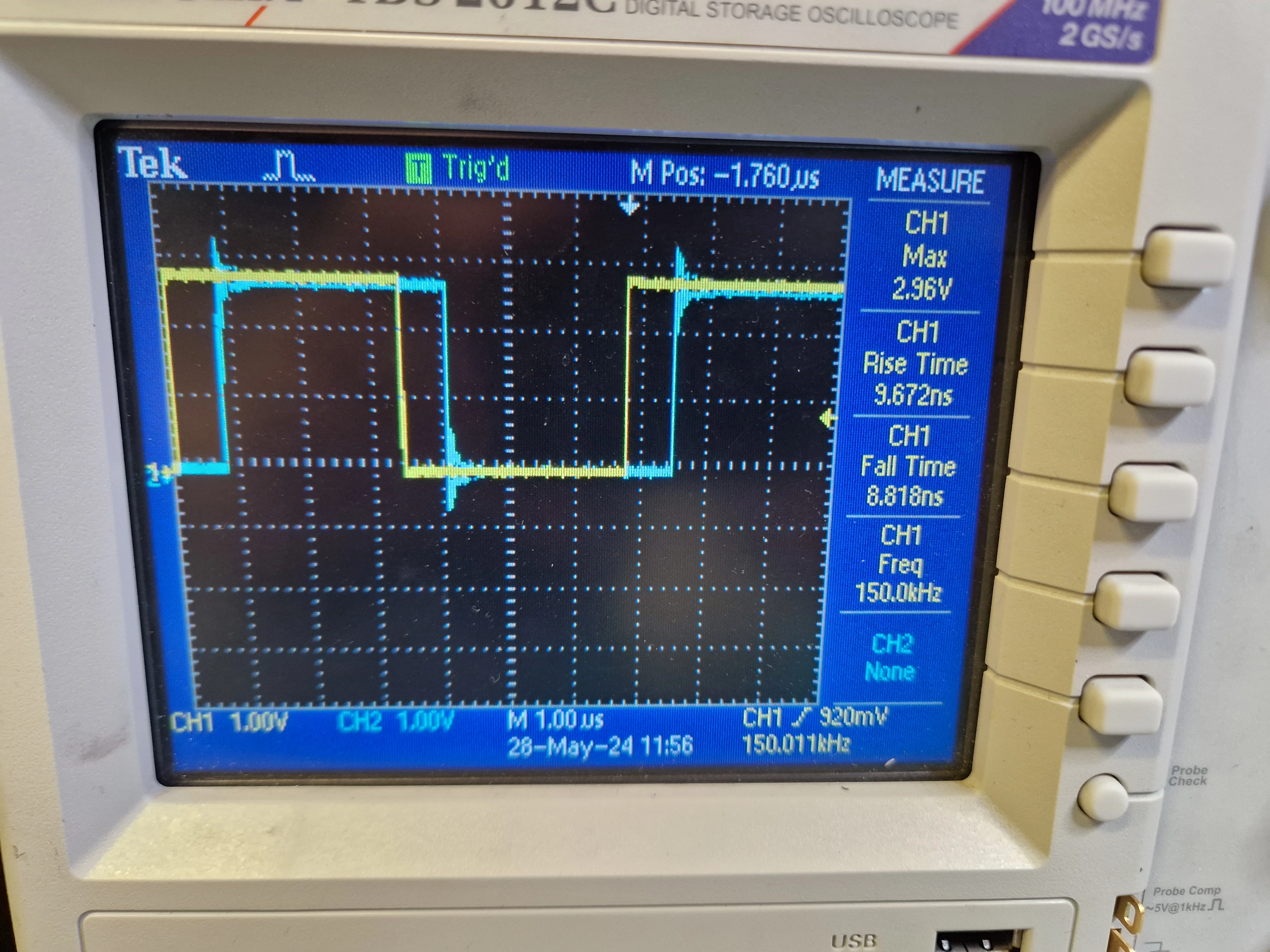

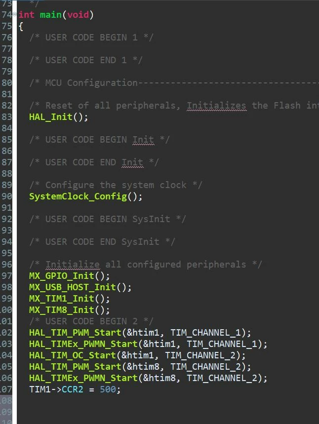

I am trying to generale phase shifted complementary PWM for PFSB control. I am using TIM1 CH1/1N to generate one pair of signals, and TIM8 CH2/2N to generate the other. To obtain the phase shift, I am using Output Compare No Output Mode at TIM1 CH2, which generates an interrupt that controls the counter of TIM8 via ITR0. When I modify the initial pulse configuration, the phase shift is achieved correctly (oscilloscope picture, yellow trace for TIM1 CH1 and blue for TIM8 CH2). However, when I try to vary TIM1->CCR2 in order to change the pulse value and essentially change the phase shift, nothing happens. Below you can see my configuration and change of CCR2 value:

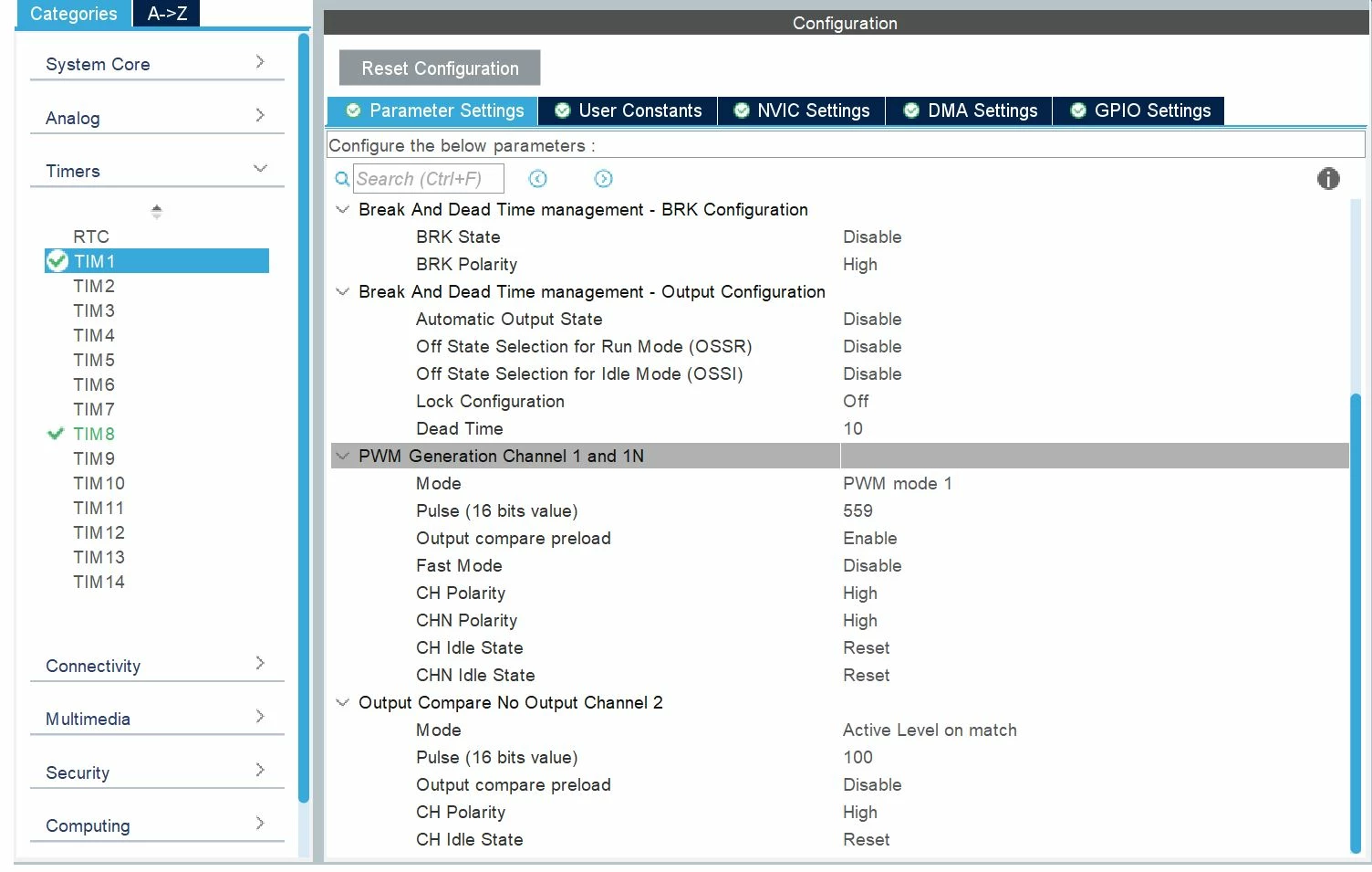

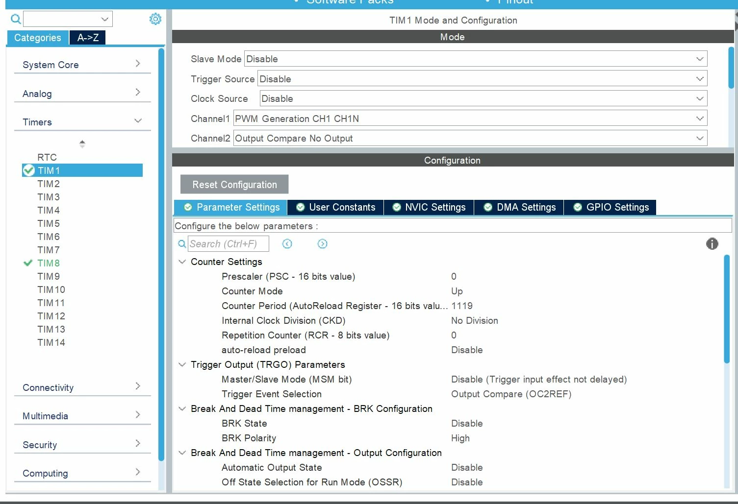

Below I attach the oscilloscope traces and screenshots of TIM1 configuration. Thank you in advance!

PS. Don't post code as screenshot; use the </> icon at top of editor pane to post code.

Channel 2 set to Output Compare No Output. Trigger event is set by OC2REF. Channel 2 mode set to active level on match, to generate a trigger event for TIM8. The counter counts up to 1119, so that value varies between 0-1119.

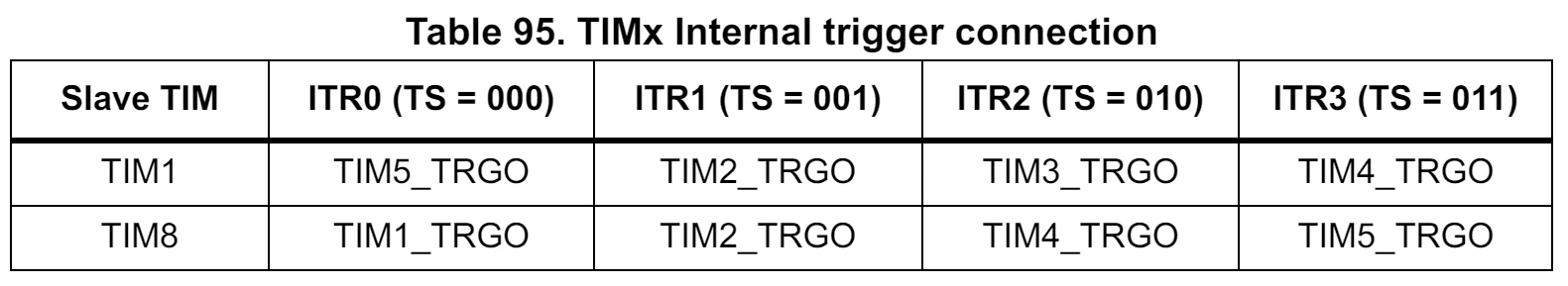

Reference Manual for the board states that TIM8 can be controlled as a slave by TIM1 via internal trigger ITR0:

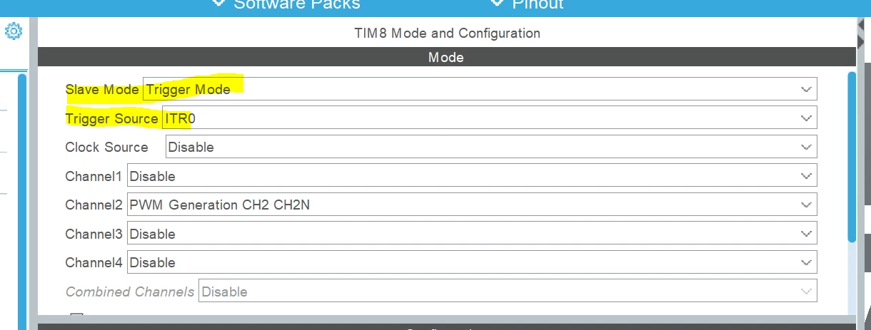

So, in the TIM8 config I set the trigger source as ITR0:
you are *not* using interrupt to control TIM8_CNT.
However, the slave-mode controller in TIM8 set to *trigger* mode does not control TIM8_CNT either.
Trigger mode does nothing else just sets TIM8_CR1.CEN. It means, that if you set up both timers but don't enable TIM8 (i.e. you don't set TIM8_CR1.CEN - Cube may do things in this way when properly clicked), the first TRGO from TIM1_CH2 sets TIM8_CR1.CEN thus starts TIM8. That's then the source of your "phase shift".
One easy and quick change is to set TIM8 slave-mode controller to Reset mode rather than Trigger.
May 28, 2024
Thanks again! I think I understand your explanation regarding TIM8_CR1.CEN - essentially TIM8 counter starts counting after the first trigger. I might have been changing TIM1->CCR2, but it didn't matter as TIM8 was not restarting.
Now, I understand that the reset mode should work as follows - when the counter on TIM1 CH2 reaches the pulse value, TIM8 will reset. I changed the mode, but it doesn't work at all. The shift is constant (despite changing the initialized pulse value) and I cannot change it during execution.
