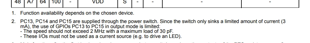

Hello @m864cdf4ac and welcome to the community.
For your information. From the datasheet / Table 8 / note 2:
January 15, 2025
Yes, we now this. This is the reason that we use the PC13 only as an activity ("blinky") LED, which draws barely tens of microamperes only (it's a very efficient LED). The catch is - the PC13 works without problems, the PC14 and PC15 don't.
