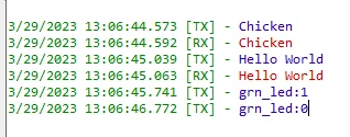

Krautermann
Senior
Mar 29, 2023 6:16 AM UTC
Thank you so much for your detailed answer! This works!!! Using Receive Interrupt and modifying the code accordingly made UART to receive the whole string instead of only the 1st char!

Krautermann
Senior
Mar 29, 2023 6:28 AM UTC
Thank you for your explanation. I guess it does make sense since HAL_UART_Transmit and HAL_UART_Receive are polling method. But by using HAL_UART_Receive_IT, it interrupts after each character and hence, enabling the reception of the whole string instead of receiving only 1 char.

The code below is using a Nucleo-G431KB dev board. UART1 is the loopback. UART2 is using the Virtual COM Port. I am using Docklight to send messages to UART2 where it gets parsed and looks for a command to turn On/Off the green led. Else it'll copy what it received and transmit it to UART1. Since UART1 it in loopback, it'll receive that string and interrupt even if there is no delimiter because the Idle bit is enabled. Then the UART1 Rx buffer is parsed and transmitted back to UART2. I am utilizing a ring buffer (size 4) so multiple commands/strings can be sent and not be missed.
Below is some text that I am sending to UART2. That gets sent to UART1 and loops back and gets sent back to UART2.
The "grn_led:n" command is turning the LED On and Off.
