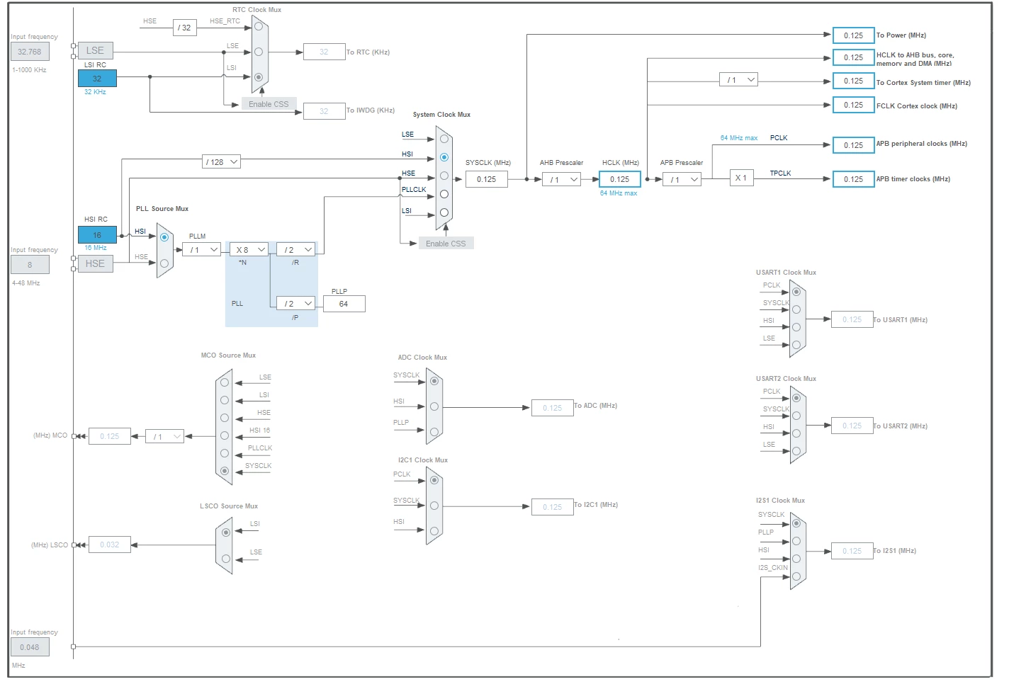

I used CubeIDE generated code with all IOs configured as analog and did not turn on any peripheral. I set the system clock at 125KHz; let it run for 4 seconds and enter "Low Power Run" mode. Based on the datasheet, it should be close to 73 uA. But my system shows 220uA.

The attached is my clock config:

I think the overconsumption you are observing is most likely coming from the HSI16MHz oscillator itself, which is ON in your experiment, but OFF in DS values (the HSE Bypass is used in that case to clock the device).
The intrinsic consumption of the HSI is around 150uA so that would fit approximately the results.
Let me know if you can check this by disabling it and trying to clock this MCU in HSE bypass mode for example?

Based on my reading on AN3430 page 7, "Another source of energy saving is to bypass the HSE oscillator and clock the STM32F2 with an external clock source, if another clock already available on the board for other devices."
Does this mean that I have to use an external crystal/clock before I can turn off the HSI and turn on the HSE bypass mode?
If that is the case, my overall power budget may not be lower at all. In our current design, we use the internal RC as the clock source.
I tried to turn on the bypass mode with my existing board, but I did see much change. Probably it is due to I do not have an HSE at all.
