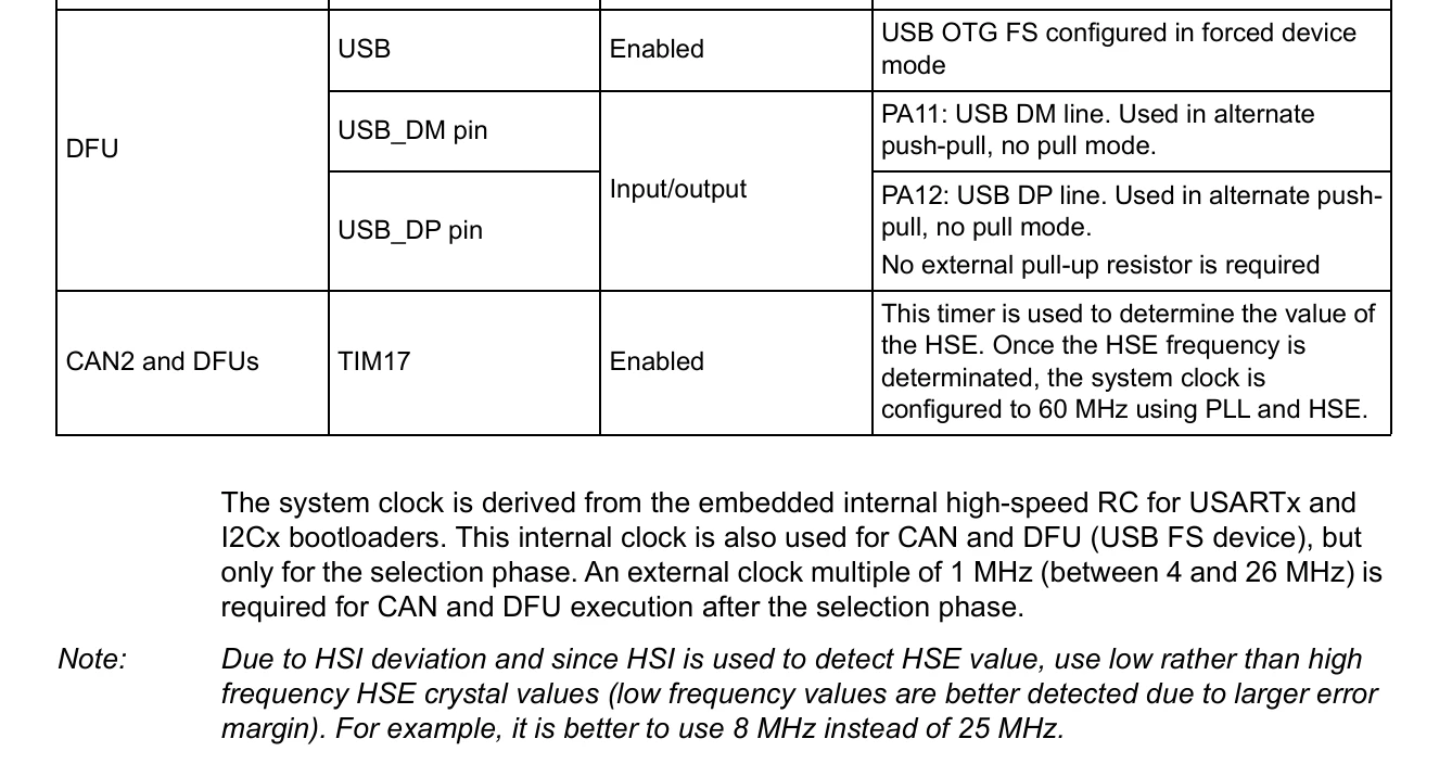

Jun 5, 2025 6:17 PM UTC
Are you sure you design meet AN2606 USB on PA11/12 and HSE as noted ?
CBarb.1
CBarb.1Author
Jun 5, 2025 6:34 PM UTC
Yes, both PA11 and PA12 are using push-pull mode, the fact is the USB DFU loader works just fine if I go into my JumpToDFUBootloader() function and hold the BOOT0 input high which is what I am trying to avoid using or if I do a reset and hold the BOOT0 input high
