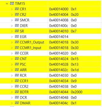

Cannot get CC1 on TIM15 to go low using CCMR1 register
Using a Nucleo-F072RB.  I am trying to get the output of CC1 to go low after the CPU does something.  Everything is working as expected except I cannot get the line to go low.  I have tried both variants of the CC1P bit and neither seems to work.  I place a breakpoint at the first line where I touch CCMR1 register and single step.  I see that the bits are as I believe they should be but for the life of me I cannot force the output line low (line 3 below --- monitoring with scope).  Can someone tell me what I am missing?

waclawek.jan
March 24, 2024
Read out and check/post content of TIM and relevant GPIO registers.
SWenn.1
SWenn.1Author
Senior III
March 25, 2024

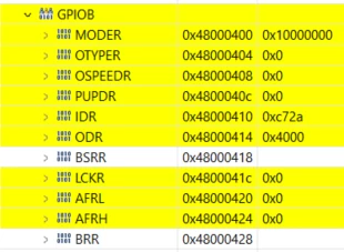

timer registers at said breakpoint in original post and GPIO (PB14 is signal I am monitoring)....this is after a reset and the 1st time hitting the breakpoint
waclawek.jan
March 25, 2024
I was hoping you were going to decipher the registers, thus find out what's wrong, yourself.
GPIOB_MODER=0x10000000
that means, the field for PB14 is set to 0b01, i.e. GPIO Output, not AF (which would be 0b10).
And AFR for PB14 is set to 0, for TIM15_CH1 it would need to be set to 1 (see Alternate functions table in DS).
In other words, you don't have PB14 set as TIM15_CH1 at all.
But even if you would have PB14 set as AF/TIM15_CH1, as both TIM15_CCER.CC1E = 0 and TIM15_BDTR.MOE = 0, that output would be disabled anyway.

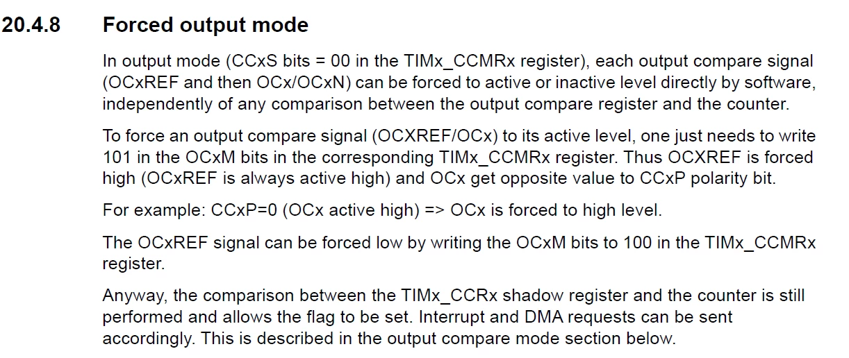

I would not have posted if I hadn't already looked at those registers (and as you seem to indicate your suggestion would not alter the outcome) ....To me they all looked fine plus the scope is showing me that the I/O is performing to the "toggle on match" as expected.  I used CubeMX to initialize things and intentionally I specifically set Channel 1 as "Output Compare No Output" and am using the I/O just as a test to validate something.  I am just trying to get the I/O low after it toggles ....
The manual clearly states:
I have tried CCxP both high and low in conjunction with using "FORCE INACTIVE" and "FORCE ACTIVE" but none of the combinations seem to work.
waclawek.jan
March 25, 2024
Not with these settings.
You have PB14 set as GPIO Out, and set to 1 in GPIOB_ODR.

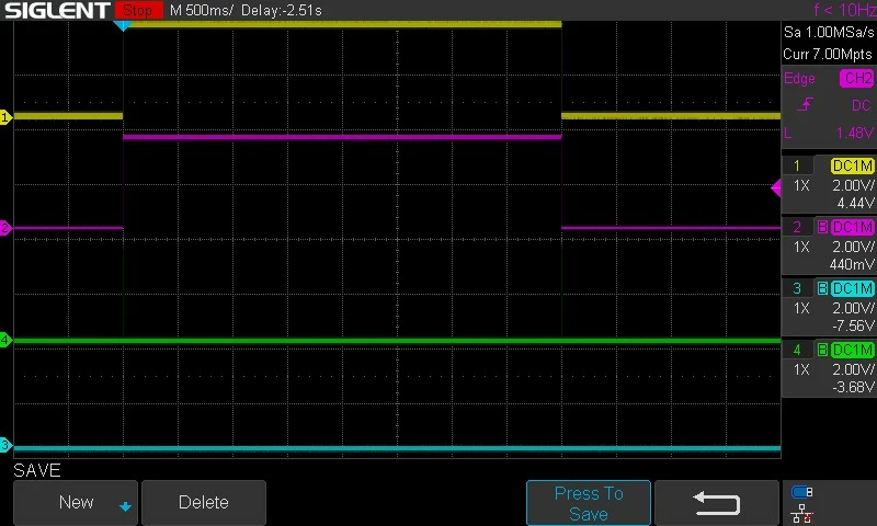

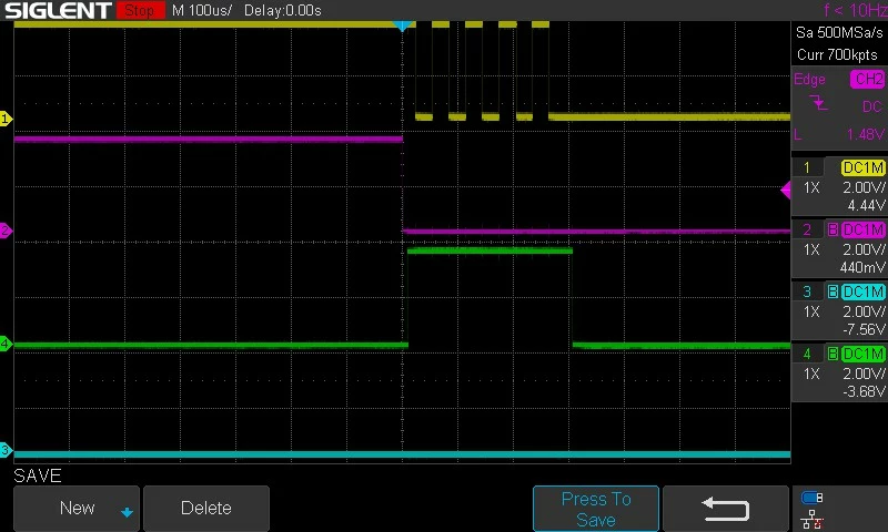

If I change GPIO->MODER to AF my signal (yellow scope trace) completely disappears.  That is not what I want.  I am bound to pin PB14 so I cannot change CCR1 in CubeMX to "Output Compare Ch1" which then forces me to use GPIO and generate an Interrupt on match. Here is a scope picture (both micro and macro) showing the issue:
It literally is just a matter of changing the toggle on the I/O to fall low at the end of each toggle.  I have attached macro and micro pics showing scope on rising and falling edge of a 4 second sample rate (pink trace).

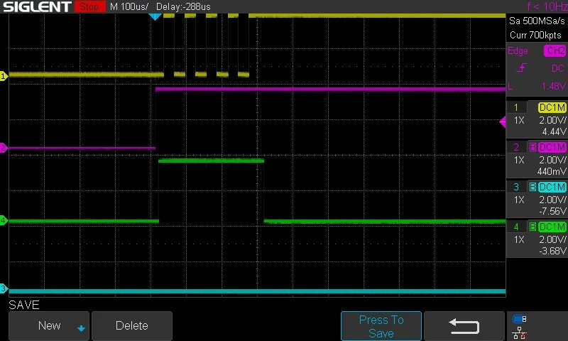

Ok....so firstly (THANK YOU for your patience!!!)....I took CubeMX and set Channel 1 as Output Compare CH1..ie AF bit gets set now...It seems the code does not touch the CCER / BDTR registers so I did this manually in the 4 second ISR.  It does not toggle (notice I removed the toggling code out of the ISR as I believe it should automatically toggle here without doing anything???).  I have attached my new code along with a scope shot showing what the yellow NOW looks like.  It toggles but stays high (what should my CCxP bit be and should I be using 'FORCE_ACTIVE' or FORCE_INACTIVE here?)
+ it looks a little strange on the tail end...any comments there?
I don't want to muddy the waters here but recall I said 7.5clks + 12.5clks at 14MHZ which means I should be able to trigger the dma with 5us....so the scope shows this toggling using your method and this is what I have been seeing using the AF....it never stops toggling and you notice the green line never goes low (I am collecting only 6 samples) ...everything breaks here
ADDITION:  I find that if I remove trying to track the A/D samples that timing looks pretty reasonable on the DMA (GREEN) time but when you add monitoring of the A/D sampling I get more toggling than samples and it won't even work (DMA never comes out of ISR to trigger the data to the UART) if I take the sampling below 15us (which is waaaaay longer than 20/14mhz needed per sample)...this translates to wasted energy

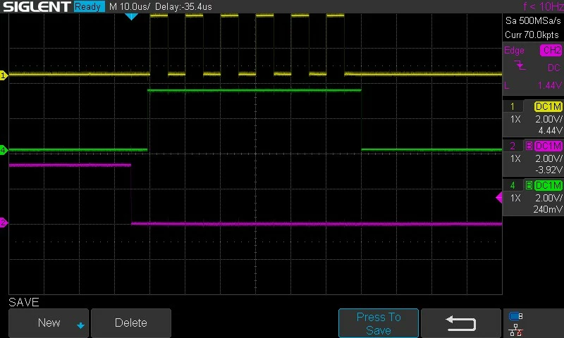

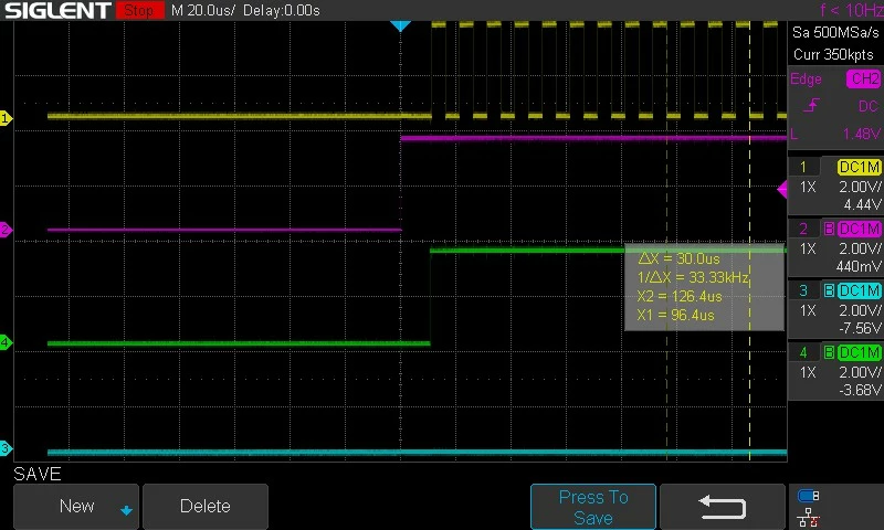

Thank you very much for all the help!  After taking your information and going back a few steps then rebuilding from scratch up I got something that works pretty well.
Your MOE and CC1E bits were important.
Clock frequency played a role as when I moved the clock up to 48MHz from 20MHz things seemed to get better.
Finally I used HAL_TIM_BASE_Start instead of HAL_TIM_BASE_Start_IT for the CCR1 output and a/d sampling.....
With that said here is a pic of my final signals....I guess it seems reasonable to think that there is a 'front' and 'back' porch for DMA as the total time for 6 samples at 5us measures about 60us instead of the theoretical 30us (5*6).  I set CCR1 to go off at 0 and toggle every 5us....As you can see there are 11 toggles (the last one going high to low does not count as this is forced active here, where active is defined as low)...
It consistently seems to do this so I think all is good here now.  YELLOW is CCR1 going off every 5us, GREEN is measuring the DMA length and PINK just represents a toggling 2 second waveform where sampling is done.
Once again thanks for the insight!
