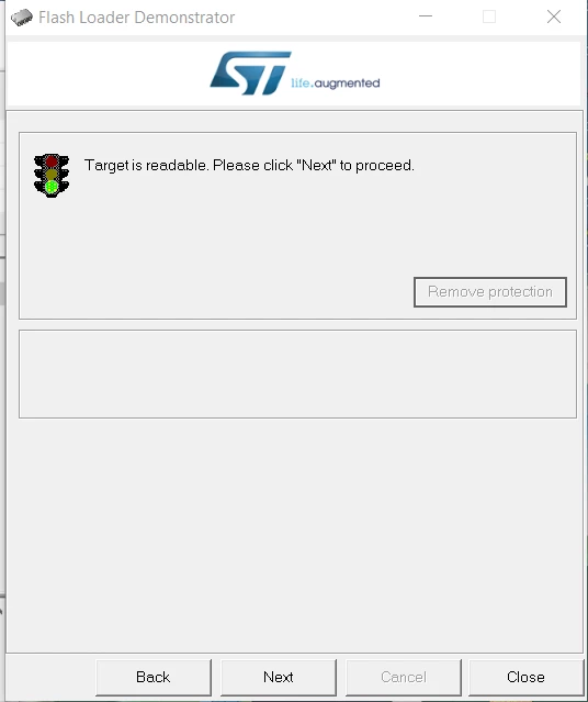

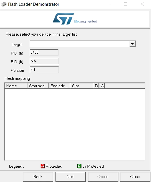

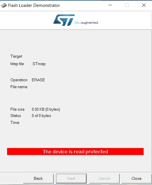

Finally after a long struggle, I was able to get into the system memory by changing to CP2102 ttl wire. Now I have another problem. Any solution to fix this?
The PCROP_PDP bit is unchecked also.

The tool you are using is very old and obsolete. Please use STM32CubeProgrammer  instead.
Refer also to this article on how to use the tool in bootloader mode with an example:
https://community.st.com/t5/stm32-mcus/how-to-use-stm32cubeprogrammer-to-access-the-usart-bootloader-on/ta-p/49608
Hope it helps.

I have been using the STM32 CubeProgrammer also and it's able to work there. Except when I change Option Bytes via UART it hangs but that isn't a problem.
I got another question. Is it possible to power the board via the VIN pins rather than the microUSB?
I have to connect the microUSB always and later connect to the bootloader via UART. Else, if I just connect via UART it doesn't work.

As you are talking about VIN pin I suppose you are using an ST board. Yes you can but you need to refer to the User Manual of the board and check the power supply section and check the usage restrictions.
