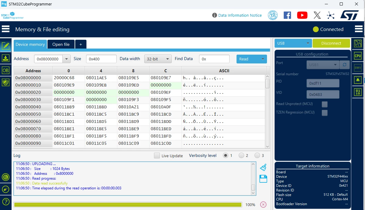

I tested Nucleo F446ZE development board (MB1137) by first setting the BOOT0 pin to a high level (3.3 V) and then performing a system reset(reset using the reset button). After the reset, I connected the USB cable to the CN3 connector (USB PORT) and plugged it into my PC.
Under these conditions, the board was detected in DFU mode by STM32CubeProgrammer, and the USB bootloader operated as expected without issues.
Additionally, I verified that the BOOT1 pin is either left floating or tied to ground, which is essential to ensure that the system memory is selected as the boot area when BOOT0 is set high.
This configuration ensures that the MCU boots from the internal system memory (ROM bootloader) rather than from user flash or SRAM.

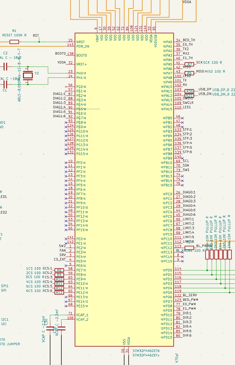

Thanks everyone for the replies. I’ve double-checked everything mentioned. BOOT0 is pulled high to 3.3 V and PB2, while i don't have it pulled down, it sits at zero, not floating, I confirmed it by probing during reset. With that setup, resetting the board and connecting either USB or UART1 produces no response at all. The chip just boots silently. I currently have no peripherals attached to the chip (removed all motor drivers, sensors, etc and nothing on uart, spi, or i2c, only just leds and mosfets)
Using CubeIDE and OpenOCD/GDB, I was able to manually force the MCU into the System Memory region by loading SP, PC, and xPSR from 0x1FFF0000. When I do this, the program counter moves into 0x1FFF50xx as expected and USB D+ finally goes high, which tells me the ROM bootloader code is executing and the FS pull-up is being asserted. However, the host still doesn’t enumerate the device, nothing new appears over USB, and CubeProgrammer doesn’t detect DFU. UART1 boot also remains completely silent (no 0x79 ACK at 115200 8E1). Outside of BOOT0 mode the chip works completely fine, USB device firmware enumerates normally, all peripherals function as expected, so the hardware itself is fine.
I’m starting to think something specific is preventing the ROM from fully initializing USB. Could it be related to the VBUS sensing on PA9? I’m feeding it 5 V, should that be lower or indirect? Or maybe the HSE startup time is too slow for the ROM, even though it runs fine in with Marlin and Klipper (8 MHz crystal with 10 pF load caps). I also wonder if there are any timing or voltage conditions that could make the ROM loader assert D+ but stop before enumeration.
At this point, it’s clear the chip isn’t entering ROM mode automatically when BOOT0 is high, it only works when forced manually through GDB, and even then enumeration never completes. Any insight on what could prevent the System Memory bootloader from taking over properly would be really appreciated.

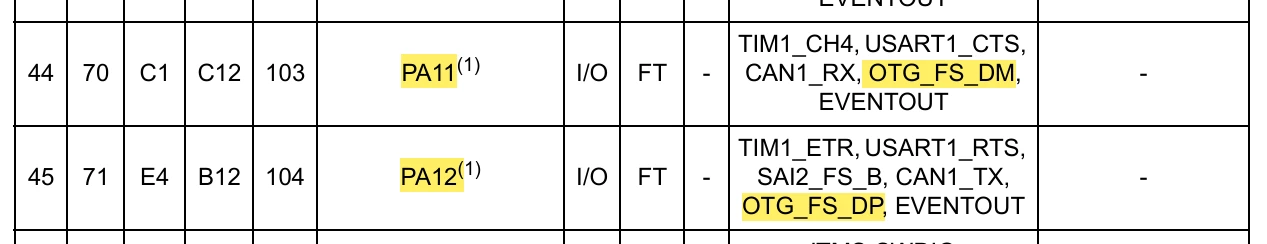

Also, your PA11/PA12 are swapped. PA11 is USB_DM and PA12 is USB_DP. Brings into question how USB is working at all.

As for the swapped PA11/PA12, yes good eye, I made a mistake in the schematic drawing, so on the board they’re physically crossed to accommodate for my *** up, so the wiring to the USB connector is correct.
