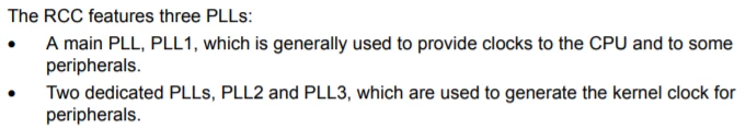

    • difference between PLL1 and PLL2 can be illustrated on following sentences from RM0433:
    • From the pinout, if you select ''RCC_MCO_2'' on PC9, you will see that you can configure parameters for PLL2P. However you cannot link it to MCO2. Then, PLL2P isn't enabled in the code. This is one of the problems you want to highlight and I'll report to MX team.
