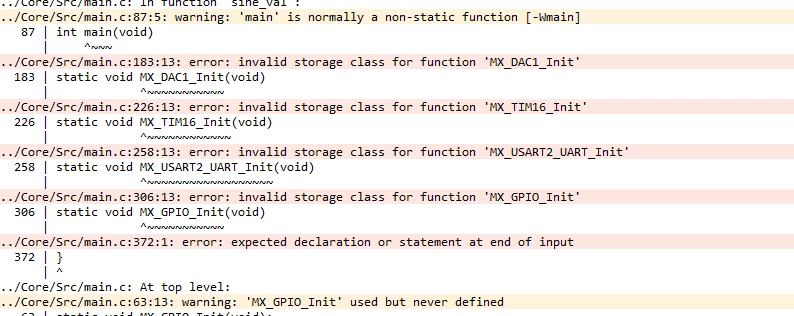

cannot debug, throwing the error
  • March 3, 2023
  • 1 reply
  • 701 views
I accidently clicked on device configuration tool code generation icon i believe and i am now unable to run the code. I am getting these bunch of errors. How do i solve this problem?0693W00000aIA5pQAG.png

    In function sine_val(), you have more opening than closing brackets.

    Thanks. That was a very silly mistake I couldn't find.
