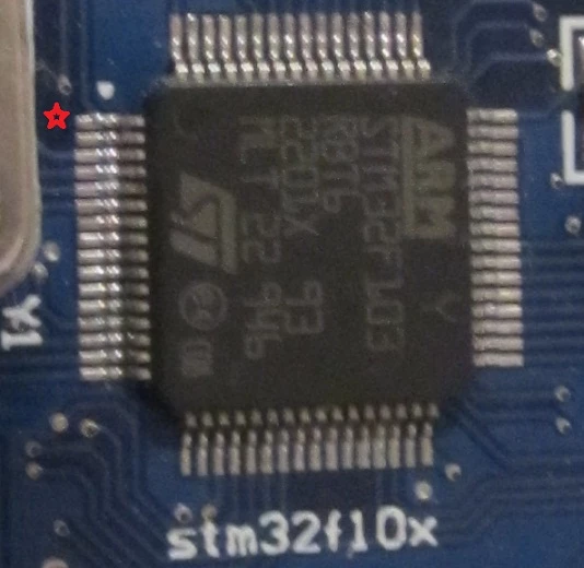

    Board makes sense, but the resolution/clarity/macro make it hard to see the marking and orientation of the STM32F4. Can you get a clearer shot, or perhaps mark where Pin 1 is?
    honboxuan
    honboxuanAuthor
    December 31, 2013
    Posted on December 31, 2012 at 16:32
    Sure thing. It's attached. Thanks for all your time thus far!
    When I was soldering the chip, I found the orientation a little confusing as well. Just in case I got it wrong, pin 1 is at the top left corner (left edge) with reference to the text on the chip.

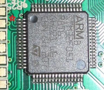

    Tesla DeLorean
    Guru
    December 31, 2013
    Posted on December 31, 2012 at 21:24
    You look to have a bunch of SMT land patterns on the board, presumably for caps and a crystal.
    Here's a 64pin F0 and F1 part, Pin 1 is marked with a red star
