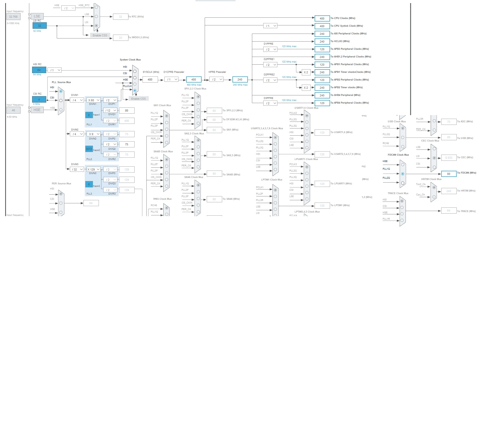

I've written a software to use the FDCAN (classic frame 500kbit/s - PB8/PB9 pins) on  Nucleo-H7ZI43 (FW_H7 V1.7.0 and stlink V3J13M4 FW)
All works fine, I'm able to transmit and to receive message with different ID and DLC by mean Innomaker CAN-USB and MCP2562FD transceiver.
If I use the same code on my  PCB and the same microcontroller, FDCAN is not initialized, no messages are transmitted or received.
The electrical configuration how you can see on the schematic attached is the same of Nucleo-H7ZI43, in this case I'm using an external stlink-v3 debugger with V3J13M4B5S1 FW.
I've checked several times the connections and electrical network, all it's correct from my point of view.
To help the analisys I'm attaching also the clock.jpeg and can.c file.
Please can you support me?
Regards
Chris
    TDKBest answer

    Why HSI?
    Does the 48 MHz HSE start?
    Does HSE_VALUE have the correct value?
    January 14, 2024
    I've used the HSI and also the HSE and nothing change.
    I've tried to provide also a 8 MHZ signal on OSC_IN and it does not work.
    What do you suggest? Please see also the schematic.
