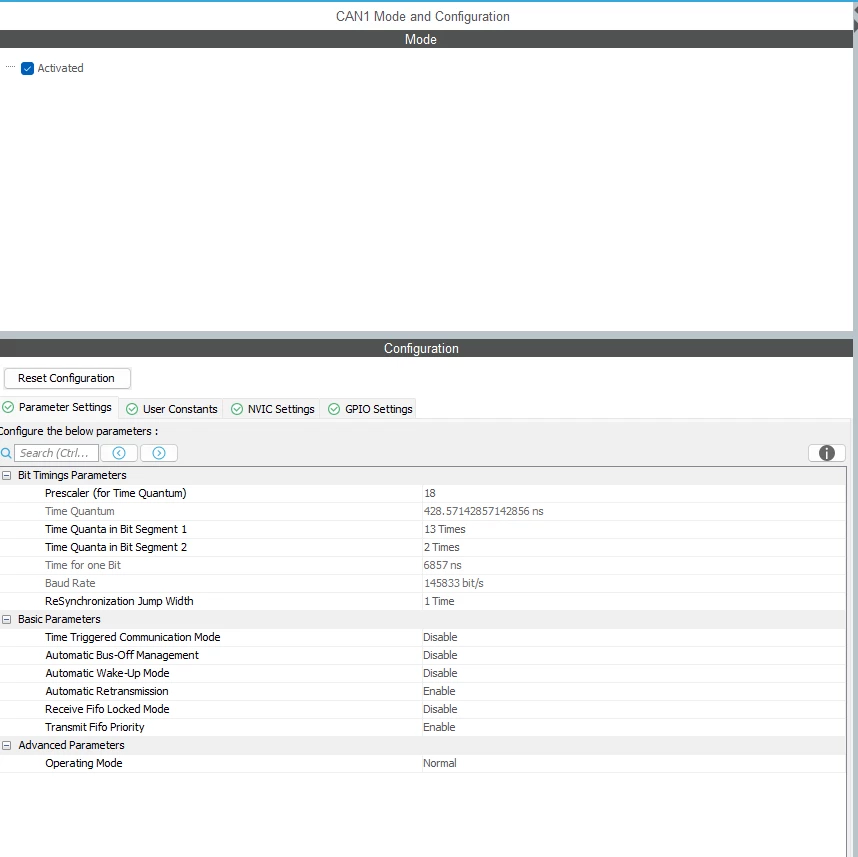

I am working with stm32f429 and cube ide.
This is my configuration for the project
 * @brief CAN1 Initialization Function
 * None
 * @retval None
static void MX_CAN1_Init(void)
 /* USER CODE BEGIN CAN1_Init 0 */
 /* USER CODE END CAN1_Init 0 */
 /* USER CODE BEGIN CAN1_Init 1 */
 /* USER CODE END CAN1_Init 1 */
 hcan1.Instance = CAN1;
 hcan1.Init.Prescaler = 18;
 hcan1.Init.Mode = CAN_MODE_NORMAL;
 hcan1.Init.SyncJumpWidth = CAN_SJW_1TQ;
 hcan1.Init.TimeSeg1 = CAN_BS1_13TQ;
 hcan1.Init.TimeSeg2 = CAN_BS2_2TQ;
 hcan1.Init.TimeTriggeredMode = DISABLE;
 hcan1.Init.AutoBusOff = DISABLE;
 hcan1.Init.AutoWakeUp = DISABLE;
 hcan1.Init.AutoRetransmission = ENABLE;
 hcan1.Init.ReceiveFifoLocked = DISABLE;
 hcan1.Init.TransmitFifoPriority = ENABLE;
 if (HAL_CAN_Init(&hcan1) != HAL_OK)
 Error_Handler();
 /* USER CODE BEGIN CAN1_Init 2 */
 /* USER CODE END CAN1_Init 2 */

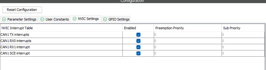

Guru
April 13, 2024
Double check NVIC settings, Vector Table entries, and linkage, the IRQHandler's themselves and that they call back into the HAL subsystem with the correct instance, that in turn calls your call back.

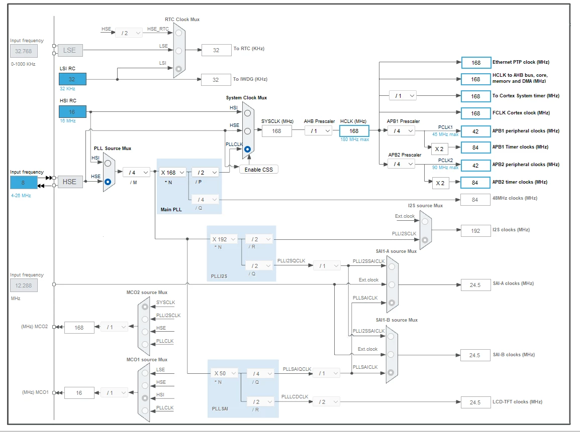

mƎALLEm
April 10, 2024
1- From the screenshot it seems you’re using an old version of CubeMx tool. Could you please tell which version you have?
2- Where is the CAN filters config?
3- I don’t see RX fifo 0 notification interrupt config in the code you shared.
4- Which board are you using? Custom board? How about your hardware? Transceiver? Bus config etc..?
SGasp.1
SGasp.1Author
April 11, 2024
Hi @mƎALLEm
1 -Cube mx version is 6.9.2

mƎALLEm
April 11, 2024
My answers in blue:
1 -Cube mx version is 6.9.2: an old version but it's OK
2- This code doesn't help as it's your implementation and needs to look at all shifts and masks (tough task)
Needs to start by a passing all messages filter to isolate the issue: is it a filter config issue or something else?
 * @brief Configure CAN message filter list.
 * This function configures a CAN message filter list based on the provided parameters.
 * filter_id_0 The ID for the first filter.
 * filter_id_1 The ID for the second filter.
 * flt_num The filter number to be configured.
 * rtr Flag indicating whether Remote Transmission Request (RTR) is enabled (1) or not (0).
 * @return HAL status indicating success or failure of the filter configuration.
static HAL_StatusTypeDef CnMsgFilterList(uint32_t filter_id_0, uint32_t filter_id_1, uint16_t flt_num, uint8_t rtr)
	CAN_FilterTypeDef can_filter = {0};
	uint32_t option = 0x04; // IDE pag 666 "Filter bank scale configuration - register organization"
	if (rtr) {
		option |= 0x02; // RTR pag 666 "Filter bank scale configuration - register organization"
	can_filter.FilterIdHigh = filter_id_0 >> 13;
	can_filter.FilterIdLow = ((filter_id_0<<3) & 0x0FFFF) | option; // EXID
	can_filter.FilterMaskIdHigh = filter_id_1 >> 13;
	if (filter_id_0 == filter_id_1)
		option |= 0x02;
	can_filter.FilterMaskIdLow = ((filter_id_1<<3) & 0x0FFFF) | option; // EXID
	can_filter.FilterMode = CAN_FILTERMODE_IDLIST;
	can_filter.FilterScale = CAN_FILTERSCALE_32BIT;
	can_filter.FilterBank = flt_num;
	can_filter.SlaveStartFilterBank = flt_num;
	can_filter.FilterActivation = ENABLE;
	can_filter.FilterFIFOAssignment = CAN_RX_FIFO0;
	return HAL_CAN_ConfigFilter(&hcan1, &can_filter);
3 - where should it be ? Need to call HAL_CAN_ActivateNotification() : from one of the examples provided in the Cube package:
 /*##-4- Activate CAN RX notification #######################################*/
 if (HAL_CAN_ActivateNotification(&CanHandle, CAN_IT_RX_FIFO0_MSG_PENDING) != HAL_OK)
 /* Notification Error */
 Error_Handler();
4- it is a custom board with a nxp transceiver. Which tranceiver? but Need to check points 1, 2 and 3 before.
Did you succeed the transmission?
