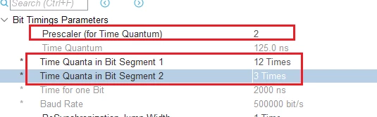

I have recently been trying to get the CAN1 bus working on the STM32F427. So far, however, it has not worked in either loopback or normal mode. For the normal mode I had a CANCaseXL Analyzer available. The problem, however, is that not even the loopback works. I have attached the main.c file and the ioc project file.
When I call HAL_CAN_AddTxMessage(), I get HAL_OK back, so that seems to work. However, I have set a breakpoint in the CAN interrupt handler (HAL_CAN_IRQHandler() in file stm32f4xx_hal_can.c) and there I see that the TERR0 bit gets set. Accordingly, the transmission process has failed. I have already tried many other possibilities, which unfortunately did not work either.
Maybe someone has an idea. Many thanks in advance!
Louis

At first check at your ioc file, I don't recommend these values for CAN bit timing:
hcan1.Init.Prescaler = 16;
hcan1.Init.TimeSeg1 = CAN_BS1_1TQ;
hcan1.Init.TimeSeg2 = CAN_BS2_2TQ;
BS1_1TQ and BS2_2TQ are very low. You need to increase them as much as possible by decreasing the prescaler as much as possible.
I recommend these values for 500kb/s:

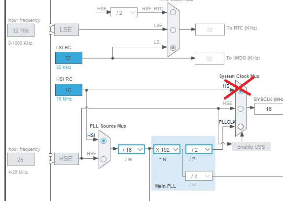

Also, we don't recommend HSI as clock source when using CAN in Normal mode. You need to use HSE with an external crystal otherwise you may face communication issues.
