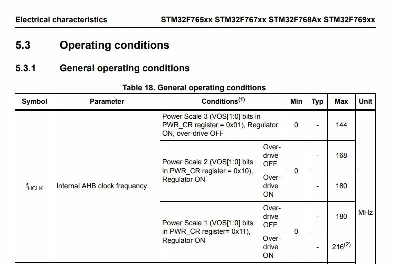

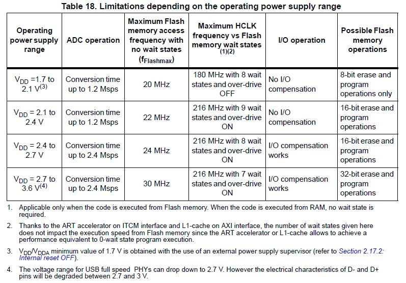

> I want to check if it can be used at 216MHz when using at 1.8V.
Table 18 suggests that the maximum is 180 MHz and overdrive must be off, which sounds sane. ST should know better, if their support will understand the question...
You will find more clarification in the following tables :

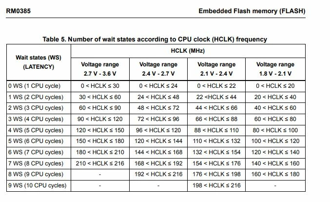

reference manual: Table "Number of wait states according to CPU clock (HCLK) frequency":
Datasheet: "Table 18. General operating conditions", note that the over-drive mode is not supported at the voltage ranges from 1.7 to 2.1 V.
I hope that is clear now for you.
