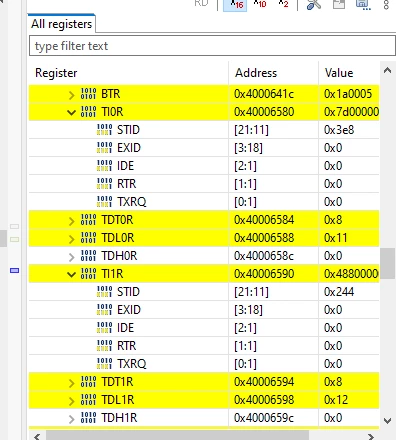

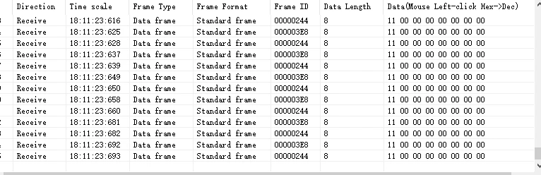

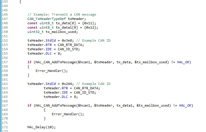

Hi
I am editing in the same post
Please check code. I am getting HAL_OK every time but unable to see TI1R data on the BUS.ONLY TI0R data I can see. even transmit mail box value getting change alternative 0 to 1 still facing the issue
	while (1)
		// Example: Transmit a CAN message
		CAN_TxHeaderTypeDef txHeader;
	 	const uint8_t tx_data[8] = {0x11};
		const uint8_t tx_data1[8] = {0x12};
		uint32_t tx_mailbox_used;
		txHeader.StdId = 0x3e8; // Example CAN ID
		txHeader.RTR = CAN_RTR_DATA;
		txHeader.IDE = CAN_ID_STD;
		txHeader.DLC = 8;
		if (HAL_CAN_AddTxMessage(&hcan1, &txHeader, tx_data, &tx_mailbox_used) != HAL_OK)
			Error_Handler();
		txHeader.StdId = 0x244; // Example CAN ID
				txHeader.DLC = 8;
		if (HAL_CAN_AddTxMessage(&hcan1, &txHeader, tx_data1, &tx_mailbox_used) != HAL_OK)
					Error_Handler();
		HAL_Delay(10);

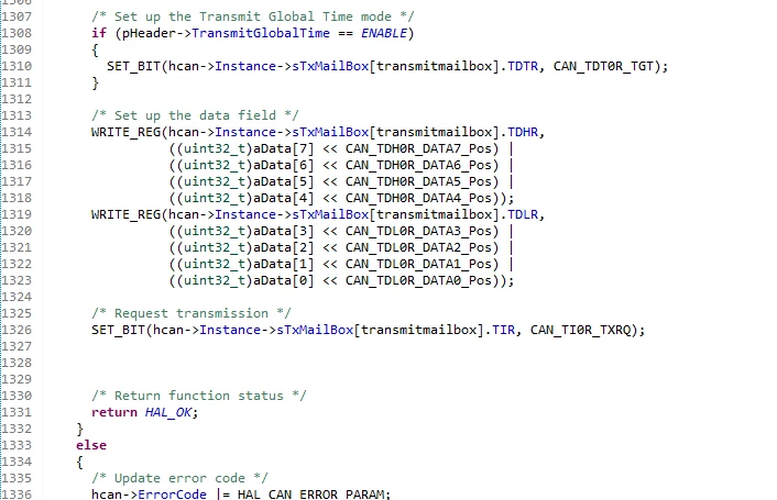

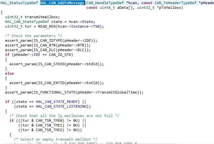

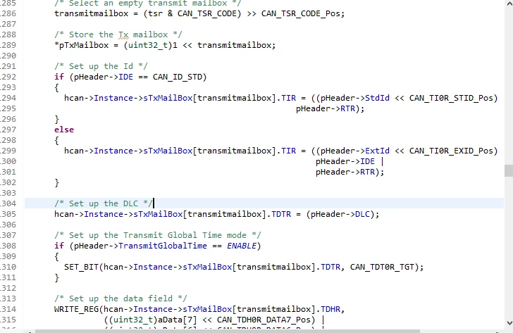

HAL_StatusTypeDef HAL_CAN_AddTxMessage(CAN_HandleTypeDef *hcan, const CAN_TxHeaderTypeDef *pHeader,
 const uint8_t aData[], uint32_t *pTxMailbox)
 uint32_t transmitmailbox;
 HAL_CAN_StateTypeDef state = hcan->State;
 uint32_t tsr = READ_REG(hcan->Instance->TSR);
 /* Check the parameters */
 assert_param(IS_CAN_IDTYPE(pHeader->IDE));
 assert_param(IS_CAN_RTR(pHeader->RTR));
 assert_param(IS_CAN_DLC(pHeader->DLC));
 if (pHeader->IDE == CAN_ID_STD)
 assert_param(IS_CAN_STDID(pHeader->StdId));
 else
 assert_param(IS_CAN_EXTID(pHeader->ExtId));
 assert_param(IS_FUNCTIONAL_STATE(pHeader->TransmitGlobalTime));
 if ((state == HAL_CAN_STATE_READY) ||
 (state == HAL_CAN_STATE_LISTENING))
 /* Check that all the Tx mailboxes are not full */
 if (((tsr & CAN_TSR_TME0) != 0U) ||
 ((tsr & CAN_TSR_TME1) != 0U) ||
 ((tsr & CAN_TSR_TME2) != 0U))
 /* Select an empty transmit mailbox */
 transmitmailbox = (tsr & CAN_TSR_CODE) >> CAN_TSR_CODE_Pos;
 /* Store the Tx mailbox */
 *pTxMailbox = (uint32_t)1 << transmitmailbox;
 /* Set up the Id */
 hcan->Instance->sTxMailBox[transmitmailbox].TIR = ((pHeader->StdId << CAN_TI0R_STID_Pos) |
 pHeader->RTR);
 else
 hcan->Instance->sTxMailBox[transmitmailbox].TIR = ((pHeader->ExtId << CAN_TI0R_EXID_Pos) |
 pHeader->IDE |
 pHeader->RTR);
 /* Set up the DLC */
 hcan->Instance->sTxMailBox[transmitmailbox].TDTR = (pHeader->DLC);
 /* Set up the Transmit Global Time mode */
 if (pHeader->TransmitGlobalTime == ENABLE)
 SET_BIT(hcan->Instance->sTxMailBox[transmitmailbox].TDTR, CAN_TDT0R_TGT);
 /* Set up the data field */
 WRITE_REG(hcan->Instance->sTxMailBox[transmitmailbox].TDHR,
 ((uint32_t)aData[7] << CAN_TDH0R_DATA7_Pos) |
 ((uint32_t)aData[6] << CAN_TDH0R_DATA6_Pos) |
 ((uint32_t)aData[5] << CAN_TDH0R_DATA5_Pos) |
 ((uint32_t)aData[4] << CAN_TDH0R_DATA4_Pos));
 WRITE_REG(hcan->Instance->sTxMailBox[transmitmailbox].TDLR,
 ((uint32_t)aData[3] << CAN_TDL0R_DATA3_Pos) |
 ((uint32_t)aData[2] << CAN_TDL0R_DATA2_Pos) |
 ((uint32_t)aData[1] << CAN_TDL0R_DATA1_Pos) |
 ((uint32_t)aData[0] << CAN_TDL0R_DATA0_Pos));
 /* Request transmission */
 SET_BIT(hcan->Instance->sTxMailBox[transmitmailbox].TIR, CAN_TI0R_TXRQ);
 /* Return function status */
 return HAL_OK;
 else
 /* Update error code */
 hcan->ErrorCode |= HAL_CAN_ERROR_PARAM;
 return HAL_ERROR;
 else
 hcan->ErrorCode |= HAL_CAN_ERROR_NOT_INITIALIZED;
 return HAL_ERROR;
