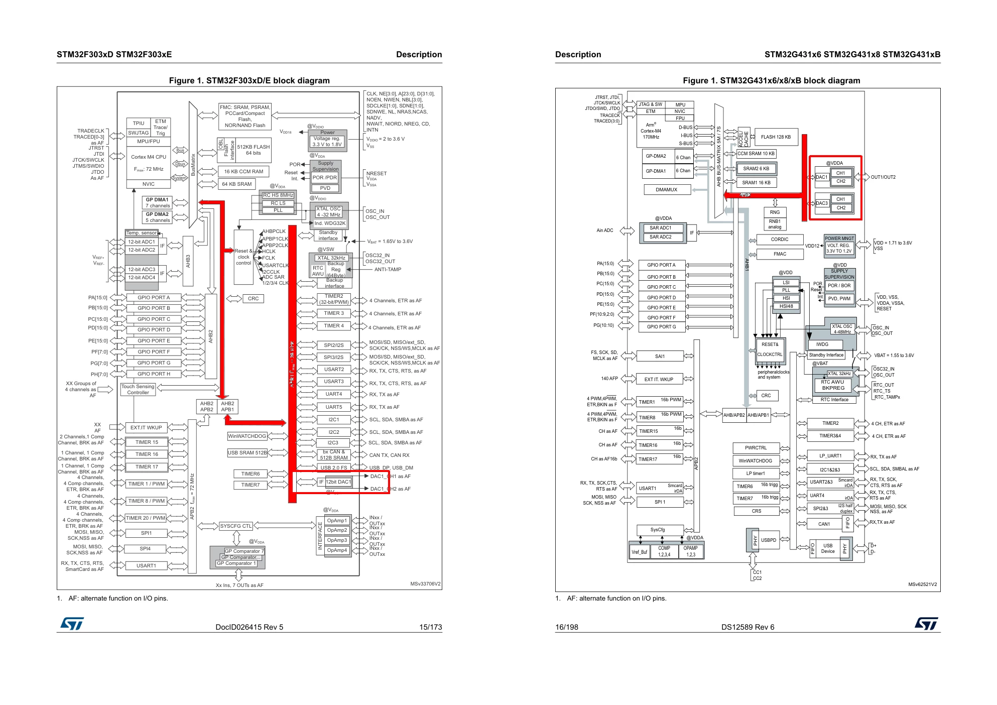

waclawek.jan
Apr 29, 2026 8:42 AM UTC
The difference here lies in the fact, that in the 'F3 DAC is located at the APB bus, and the AHB-to-APB bridge is forgiving, i.e. it does not enforce access width. In contrast, in the 'G4, the DAC - quite inexplicably, to me - is directly at the AHB bus, and it's designed so that it does not support non-word-width accesses, and signals bus error to the master which attempts such access. In case of DMA, it results in Transfer Error and the given Channel being stopped.

waclawek.jan
Apr 29, 2026 12:17 PM UTC
Define "properly".
The 'G4 RM says, in DAC registers subchapter:
The peripheral registers have to be accessed by words (32-bit).
But the exact same sentence is also in the DAC registers in RM0316 for 'F3...
The difference is, that if write 16 bits into DAC registers in 'F3, the AHB/APB bridge takes those 16 bits from AHB and quietly duplicates them to the other halfword to APB and does not assert the transfer error signal. This duplication is somewhat documented in RM0316 in 3.1.5 BusMatrix/AHB/APB bridges chapter.
What is "improper" here is the "integration" aspect of this - you can find the individual snippets of information which is directly related to the individual "components" (such as DMA, bus matrix, DAC), but these snippets are not brought together so it's left to the user to assemble the whole picture... This is the price we pay for the "lego"-style using which these chips are designed.
