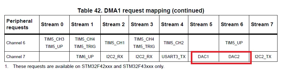

Hello @macam1 ,
If you mean data transfer from memory to DAC with DMA, yes it's possible.
You didn't mention  the exact STM32F4 part number.
This is for STM32F4x7 using DMA1:

macam1Author
Dec 11, 2024 8:36 AM UTC
thank you for your response, yes using stm32f405. can you give an explanation about this dma memory access, I'm so blind.
mƎALLEm
Dec 11, 2024 8:50 AM UTC
What explanation you need?
You need to configure DMA and DAC especially to choose the correct DMA stream and DMA channel (see the figure I shared above).
Please refer to this example. It's using DMA and DAC for signal generation:
https://github.com/STMicroelectronics/STM32CubeF4/tree/master/Projects/STM324xG_EVAL/Examples/DAC/DAC_SignalsGeneration
