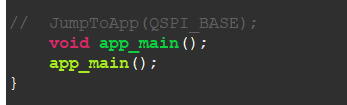

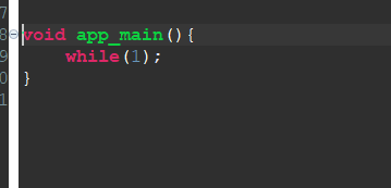

I have a bootloader project that can jump to a QSPI application under normal conditions. When I first install this application and then install my application that I created separately for QSPI, it works without any problem.(Bootloader + App).

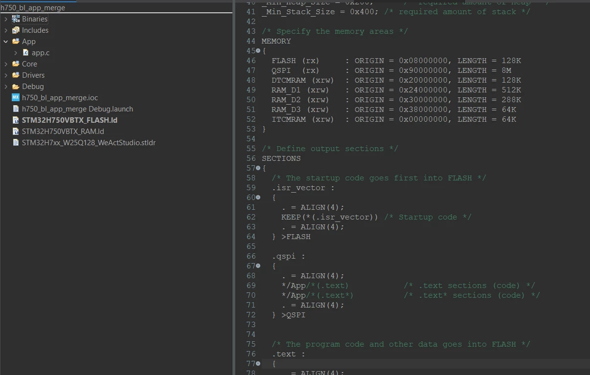

But what I want to do is to combine bootloader and application projects. I tried to add the App code into the Bootloader application with a method like below, but even if the compilation result was successful, the debugger gave an error and I could not load the application to flash.
My App Code
Jump Code

Well calling main() in an entirely different application won't correctly initialize the statics, ie your variables, either with content, or zeros.
The idea is that the Boot Loader and Applications are two separate entities, and can reuse RAM independently.
Now with the STM32 and QSPI you REALLY want the loader to bring up the bulk of the system, things like the primary clocking, PLL, external memories (peripherals and pins). The QSPI needs to be viable before you can copy content from it and execute.
It is best to do this ONCE and EARLY, so the system is running at optimum speed, and you don't have to worry about the ground underneath you shifting.
Not sure how well CubeIDE permits multiple builds under one project, they allow for Debug / Release, but things like Keil allow for one project to have multiple build contexts, allowing for a Boot Loader, with it's own main.c, main(), vectors etc.
I don't know if this is significantly helpful, even for source code control, as loaders typically don't need to do a lot of faffing around, they have a very simple defined goal, and shouldn't need constant rework over the life of a project/design. They just need to get the board to basic viability, sanity check the application image, and transfer control. Perhaps allow for recognizing and update condition, and replacing old app with new one.
Build the loader for 0x08000000 and the app for 0x90000000, have them be operationally independent, and don't have the app mess with the PLL, MCU or QSPI, except for situations where you account for the fact you can't break the memory you're currently executing from.

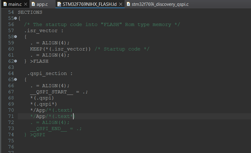

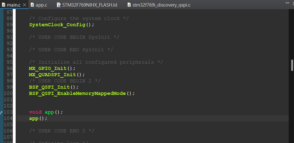

Actually, when I tried a similar code with f769-disco, no problem. I'm not sure but the external loader seems to corrupt the FLASH SECTIONs content. Also now I can't even use the QSPI memory as read only (BL+APP is no longer. like FLASH + QSPI). Whe external loader can't be used with FLASH section (0x08000000).
OguzhanBalci
May 20, 2024
same app on f769 fully working
I think there is a problem either in the mcu or in the external loader. Is it possible that the external loader can access the flash section?

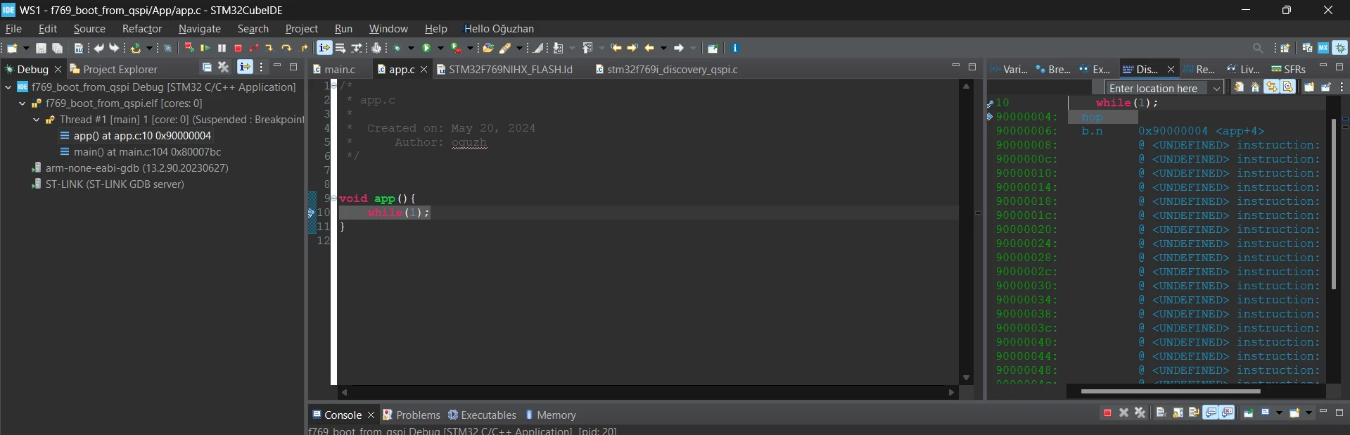

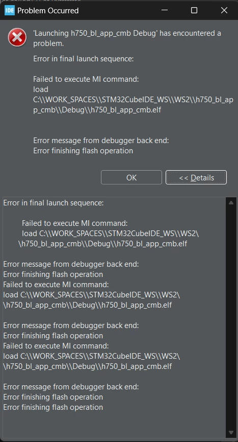

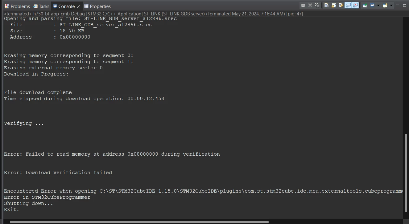

There is still a problem uploading the code
I used the appropriate external loader from the repo you suggested (it works on its own without any problems)
