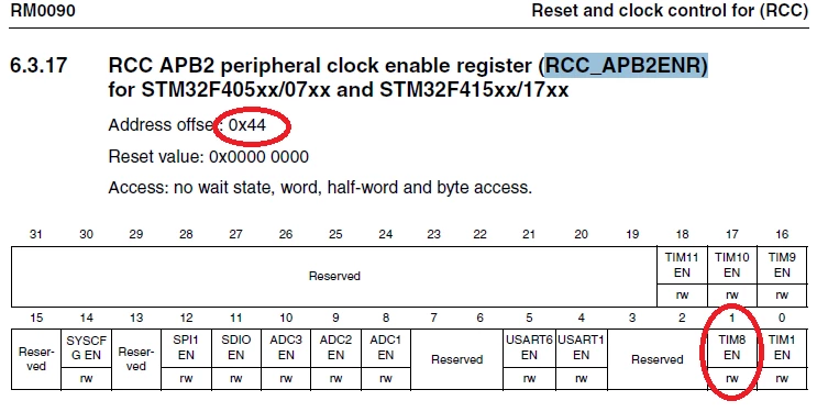

I have begun programming the stm32f4.  I made a really simple program first.  It added one to r0 and stored the result in r0.  Then I used
STM32 ST-LINK utility
to confirm that r0 is increasing.  It was.  I though I was on my way ... until now
I made a program that still increments the registers, but I also setup timer8 for output compare to make a simple timer.  The output pin I used does not change state.  I used
to look at the memory contentes around the boundary address of timer 8 and found all the memory in that area is zeros.  I tried to use the utility to change one of the timer 8 registers manually, and it told me ''error occurred during memory writing.''  The flash area of the memory displays correctly.
Am I just unable to interact with the peripheral memory with
am I writing to the peripheral registers improperly?
perhaps the registers for timer 8 are written to but I set them up wrong to strobe an output pin?
my small code follows.

You must enable the AHBx and APBx clocks for the peripherals you wish to use.
ie APB2ENR and SYSCFG
LDR R0, =0x40023844 ; RCC_APB2ENR
LDR R1, =0x00004000 ; ENABLE SYSCFG CLOCK
STR R1, [R0, #0]
Tesla DeLorean
Guru
Aug 6, 2013 9:06 PM UTC
Posted on August 06, 2013 at 23:06
ldr r0, =0x40023800 ; RCC
ldr r1, =4 ; RCC_AHB1ENR_GPIOCEN
ldr r2, [r0, #0x30] ; RCC_AHB1ENR
orr r2, r1
str r2, [r0, #0x30]
ldr r1, =2 ; RCC_APB2ENR_TIM8EN
ldr r2, [r0, #0x44] ; RCC_APB2ENR
orr r2, r1
str r2, [r0, #0x44]
; OR
ldr r1, [r0, #0x30] ; RCC_AHB1ENR
orr r1, r1, #4 ; RCC_AHB1ENR_GPIOCEN
str r1, [r0, #0x30]
ldr r1, [r0, #0x44] ; RCC_APB2ENR
orr r1, r1, #2 ; RCC_APB2ENR_TIM8EN
str r1, [r0, #0x44]
drobison
drobisonAuthor
Aug 6, 2013 9:19 PM UTC
Posted on August 06, 2013 at 23:19
Thanks for the reply.  I'll try it; however;  I am further confused.  When I look at your assignment for the RCC register, I get the impression you are setting bit 13, which is reserved.  I would expect you want to set bit 1 which is timer 8.  I expect 0x0002.
Is my concept of byte order wrong?
Tesla DeLorean
Guru
Aug 6, 2013 10:14 PM UTC
Posted on August 07, 2013 at 00:14
We're talking about the F4, right?
