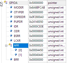

    GPIOA:

    found it, need ARR = 0xFFFF and timer need to be anabled , CR1 = 0x01
