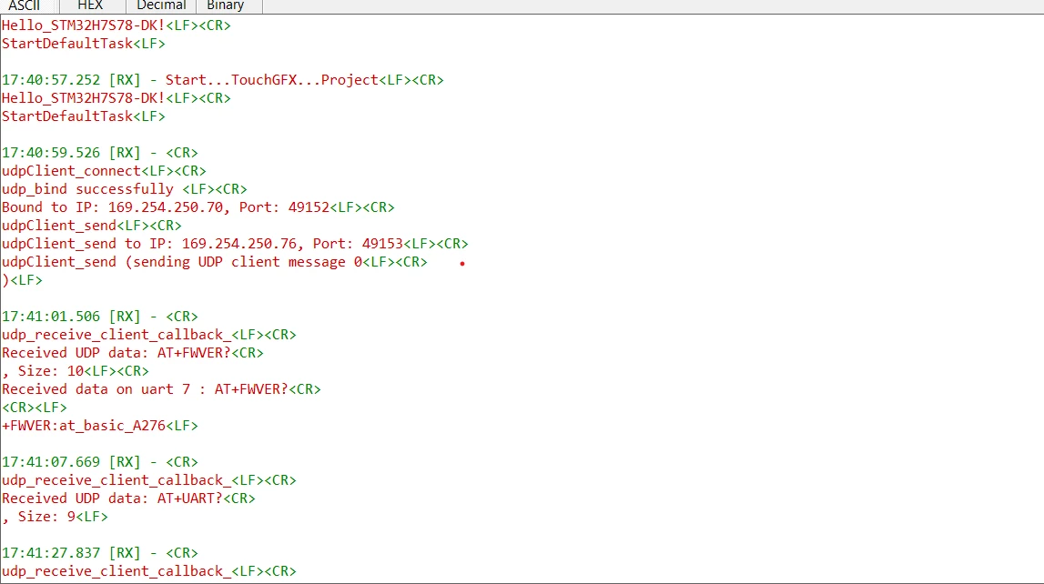

Jan 21, 2025 12:19 PM UTC
Hi @Andrew Neil ,
Thanks for answering but I need UART4 for debugging purpose.
One thing I need to add in this thread,
When I was trying HAL_UART_Receive_IT function and  send cmd from Ethernet, I get response from UART7 but it happens only once(at very first time) then i am not able to get response even after sending same or different cmd.
But when I use HAL_UARTEx_ReceiveToIdle_IT , I am not able to get response even single time.
Here is the screenshot of response i get from UART7 when i send cmd from UART7.
/Mehul
So how are you connecting UART7 to that terminal?
