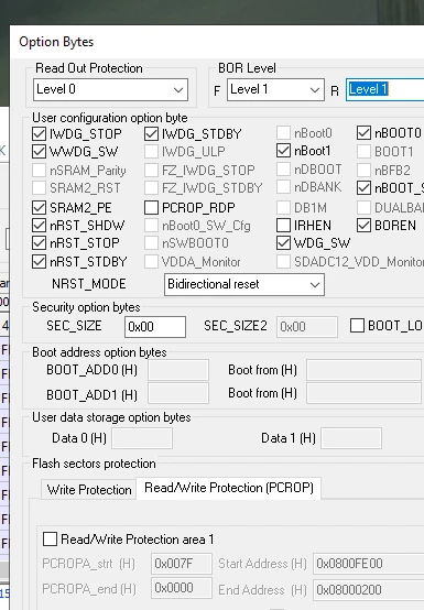

I have tried everything I can think of to get part to program, I still get this:
The elf loader Sector Erase function fails.
Memory-Loader error
Error occured during erase operation!
Programming error @ 0x08000000!
I have tried STL CLI, JFlash-lite, JFlash, STM32Cubeprogrammer, always the same thng.
If anyone has any ideas I would be grateful.

  1. Make PCROP_RDP checked, enable RDP level 1
  2. Program option bytes.
  3. Disable RDP.
  4. MCU should be erased to 0xFFFFFFFF
That actually worked!  Found it on another thread.

Hello @mark4444az
Is it a custom board? If yes do you have checked SWD connection?
If you are able to etablish a SWD connection with STM32CubeProgrammer, check option byte if the device is not protected (RDP ?)
BR

I am using an STLink-V3Minie. I can look at the Option Bytes:
The Read/Write Protection is not checked so it is not on. Further, I have tried the JLinkSTM32 executable to reset options back to factory settings, said that  worked.

did you try loading a bin or hex file ?
+ another chip ? maybe this one has a "problem" .
July 19, 2023
Yes, replaced the processor and programmed with gui and it's ok. The issue appears to be in my script file:
ST-LINK_CLI.exe -c SN=002000283431511737393330 -p RAD3.hex 0x08000000 -v -rst
When I use that it seems to brick the uP.
