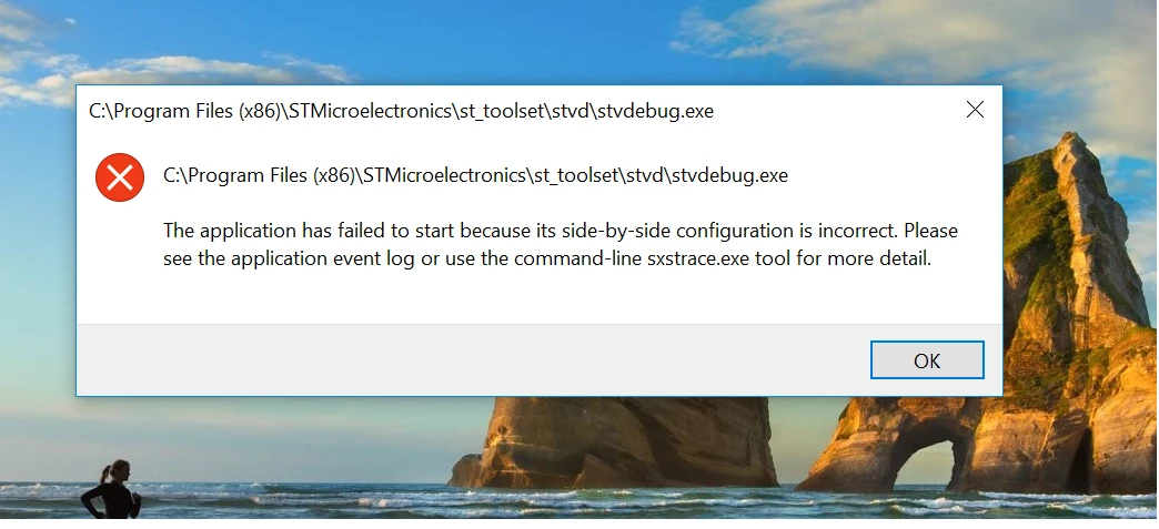

Hi All,
I want to ask as i recently installed the STDV software in my new laptop window10 but i can't open it. Can please help me to solve this problem. Much appreciated for your kind help. Thanks.

    Install Microsoft .NET or Visual C runtime DLLs, as the redistributable components appear to be missing from this new system.
