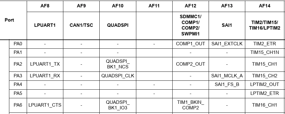

I want to use input capture mode in my stm32l432kc nucleo-32 board to measure the length of a signal from a sensor of mine. I have set it up the following way:

I have used GPIO_AF14_TIM16 in the GPIO configuration, since the datasheet in the manual contained the following table: https://imgur.com/a/BwVqaxh, I'm not 100% sure that it's correct though.
Does someone have an idea on what I'm doing wrong here?
Thanks in advance!

The tim init seems ok.
And how you start the tim capture action ?

Ok I found the problem, but I don't understand it yet.
The general idea is that I want to write to PA6 first (the start signal for my sensor) and then switch to the input capture mode to measure the response signal length of the sensor on PA6.

AScha.3
October 20, 2024
You cannot use the pin for different functions same time.
If you want do it, you have to set it to the function (AF setting) you want then,
so if using the pin as gpio , but then as af tim input, you have to switch it to this af again, before use sf function.
So set pin pa6 to af14 , after using it as gpio, before expecting it to act  as af14.
