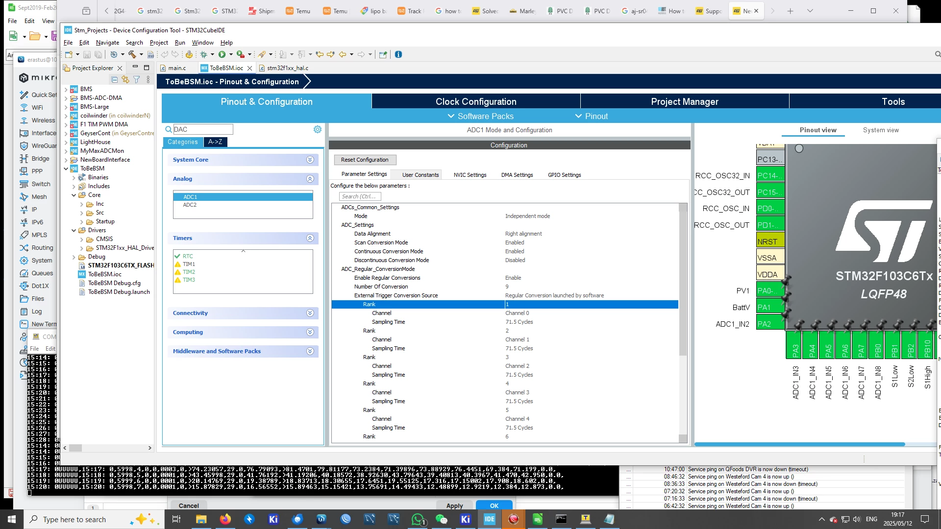

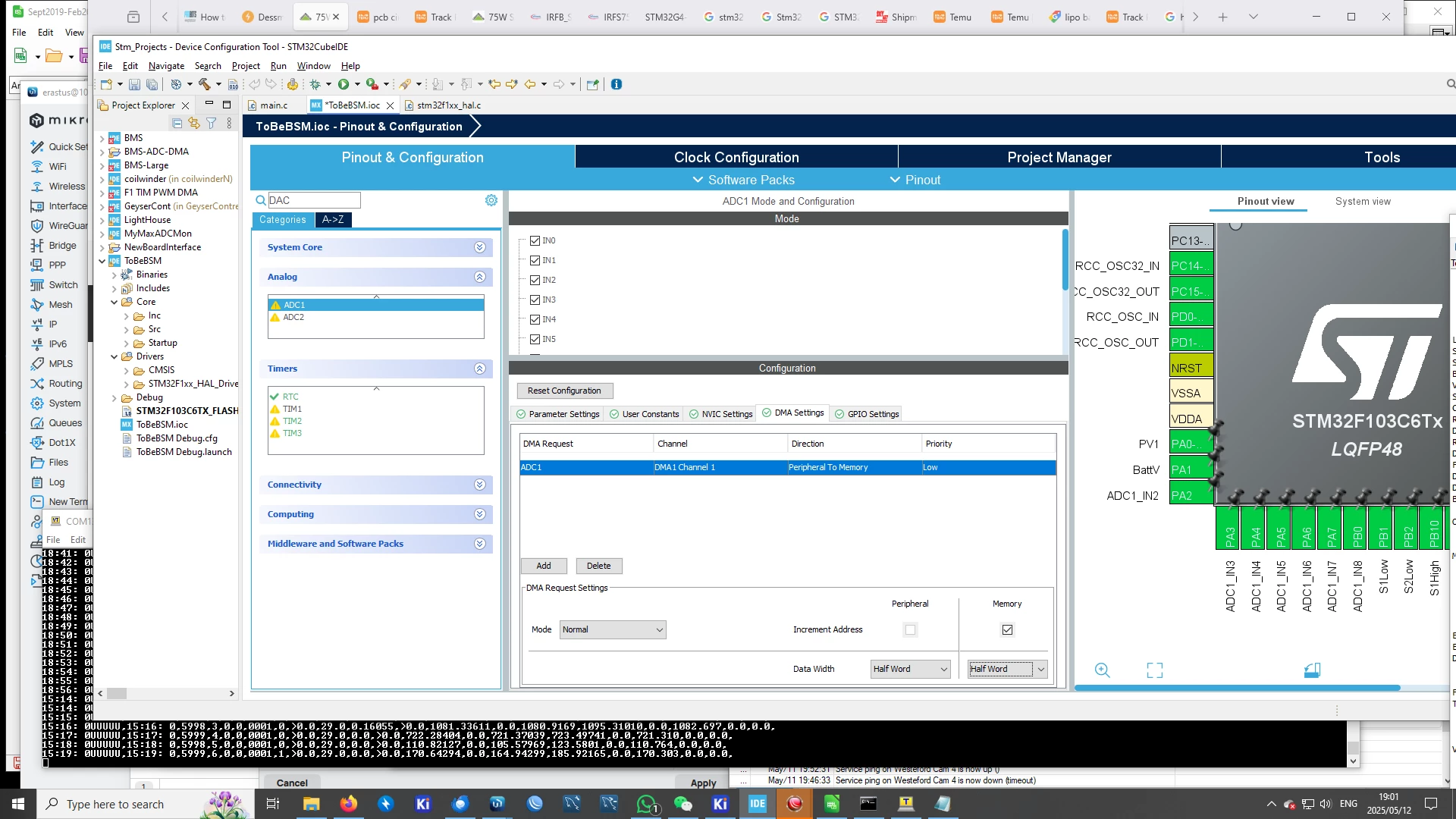

I have4 set up a 9 channel DMA adc
Below is the DMA configuration in the IDE
This is the ADC configuration

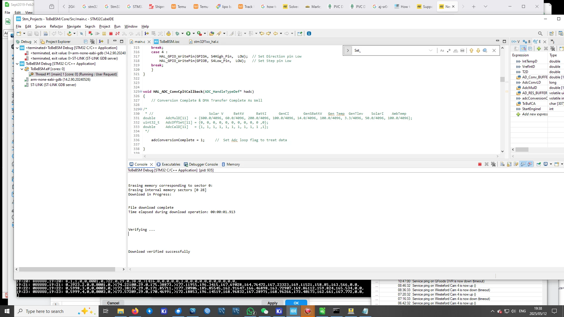

This is the IRQ routine

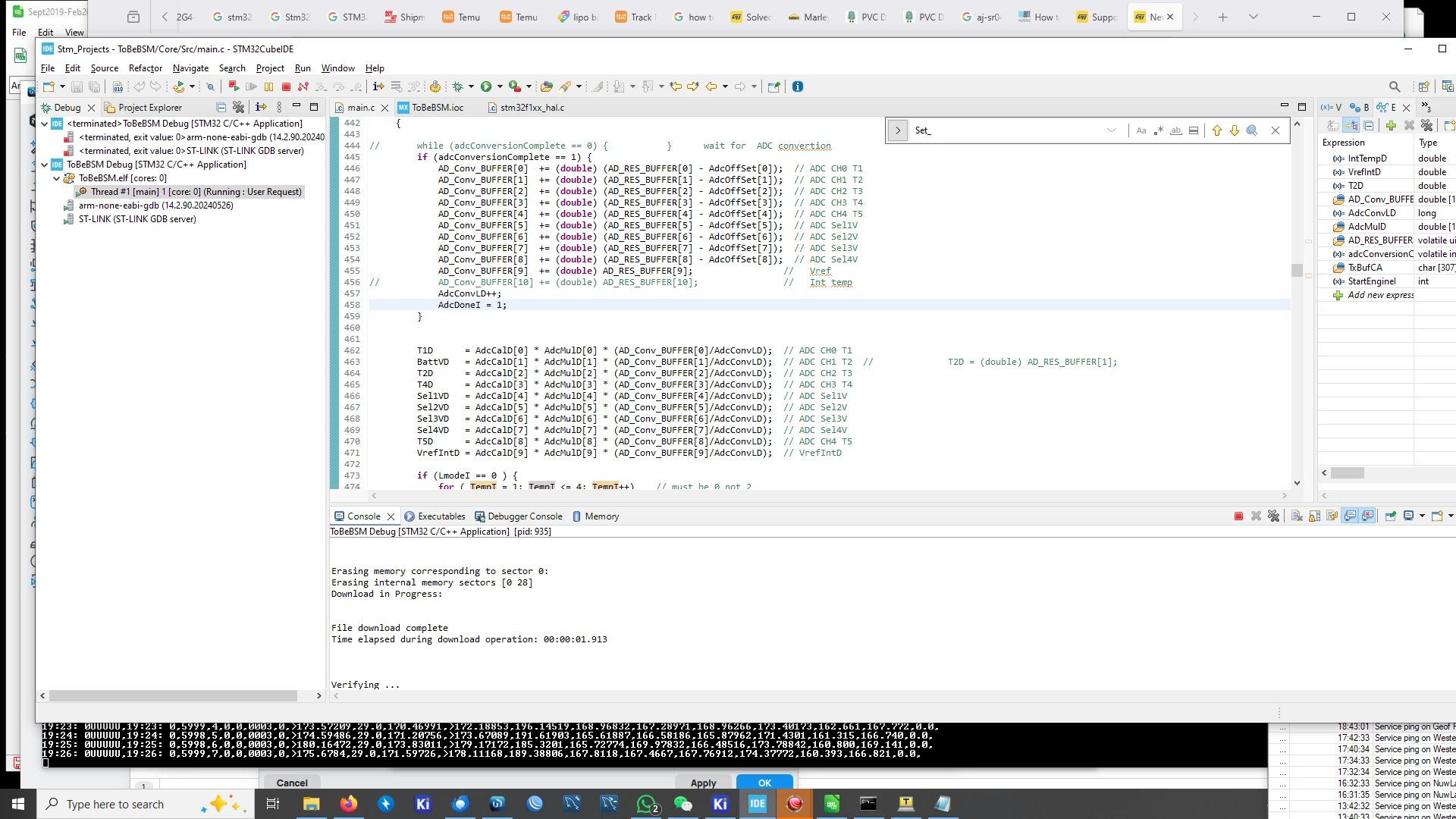

This is where I treat the data.  For every loop it gets added to another array after the conversion.
Then a simple routine that divides the accumulated value by the amount of conversion and then some tweaking

It seems that the conversion get scattered on all the channels and the max reading I can get is 170 with 1.3V on A0.
This is the aray  volatile:
uint16_t AD_RES_BUFFER[11] = {0, 0, 0, 0, 0, 0, 0, 0, 0, 0, 0};
I am not sure what is happening can any one please assist.

Hi @erastusC ,
I would suggest simplifying your setup to reproduce the issue with fewer variables and fewer possible places where a mistake might be made.
A single channel ADC with input connected to 0 or 3.3v should result in the full ADC range, and once that's working you could start adding complexity such as: enable cache (if wanted), add DMA, multiple channels and your post-processing code etc.
Good luck, hope this helps.

I did find the fault.
HAL_ADC_Start_DMA(&hadc1, (uint32_t*) AD_RES_BUFFER, 9);
The 9 was set to 11.  11 For ref and internal temp.
I expected the "driver" to start from channel 01 (1) which it did not do.
My fault.
