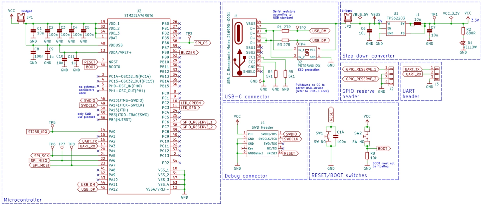

I made some custom PCB's with a STM32L476RG. Here are some of the features:
-USB-C connector (CC channel configured as device) with DM/DP routed to PA11/PA12.
-Step down converter 5V (VBUS USB) to 3.3V (VCC for most components)
-Tactile switches for BOOT and RESET
-10 Pin SWD Debug header: SWDIO/SWDCLK -> PA13/PA14. SWO not routed.
-no external crystals
I soldered one PCB up and checked the connections under the microscope and with some resistance measuring. So that should be fine.

Schematics would be more useful than a list of features
JonasHSLUAuthor
May 21, 2025 8:58 AM UTC
As mentionend, I don't think I can share the whole schematics. But in hindsight I could have posted at least some parts:

So probably an issue with power or orientation.
Do you mean orientation in terms of package placement? If yes I was quite unsure at first too, because the LQFP64 has two circular markings. However, pin 1 should be on the lower left when the text is readable if I'm not mistaken.
Check voltage presented on NRST pin.
Check all supply pins, analogue and digital.
I checked the voltage on all 6 supply pins (see schematics in my reply to @Andrew Neil) and on NRST and they all have 3V. Before I had some problems with my DCDC converter only giving 2.4V but to my understanding that shouldn't have done any damage, as the Vin range is 1.8-3.6V. Now it still doesn't quite reach the targeted 3.3V, could that cause some problems?

However, ( @Tesla DeLorean ) I now managed to program the target using the ST-Link Utility after setting the frequency to 1.8MHz. But it's not really stable as most of the time I still get error messages when trying to perform a full erase or program my SW on it. Also: debug and run still don't work.
Have you checked if there's excessive current draw or if the MCU gets warm?
Did you buy the STM32 from a reliable source?
I got the STM32 from mouser and it doesn't get warm. The DCDC converter that supplies the MuP gets quite warm and doesn't reach the 3.3V (it is a fixed output variant, settles at ~3V).
JonasHSLUAuthorBest answer
May 21, 2025 12:11 PM UTC
Update: used a segger j-link debugger and it works without any trouble.
