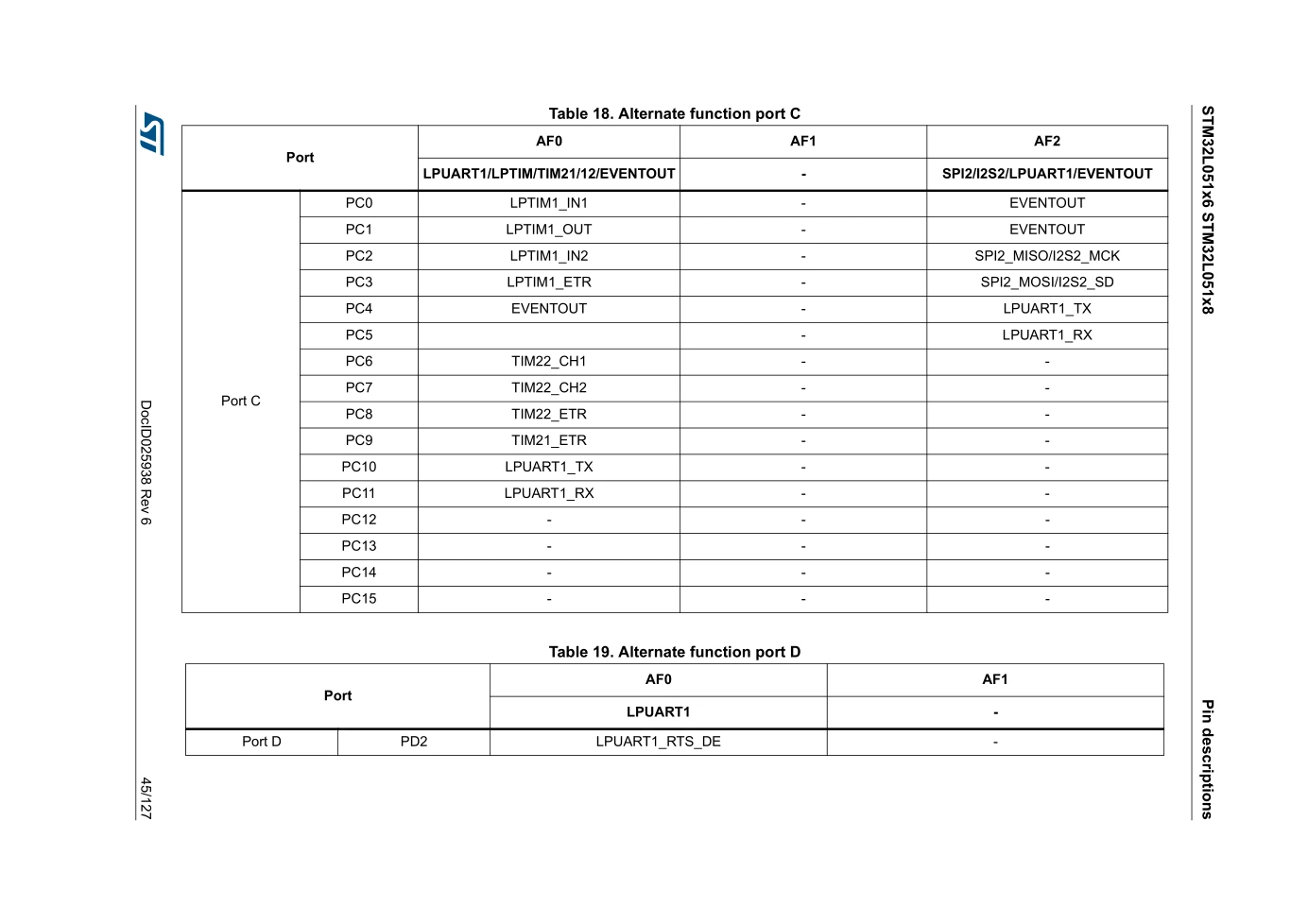

Can't find alternate funcions description on the Port C on STM32L051x6 x8

Reading the datasheet, on the Port C are reported several alternate functions. But the descrption of AF it is only for port A and B.
Is it possible to have the AF descrption for the Port C too? Could take quite a long time to guss the correct mux.

From an older version of DS:
0693W00000LwPc0QAF.pngJW

Jan, thank you.
It seems tha part that lacks in the recent versions..

Hi All,
The table you have shared is correct.
I asked for the document correction update in internal ticket 125576.
(PS: This is an internal tracking number and is not accessible or usable by customers).
