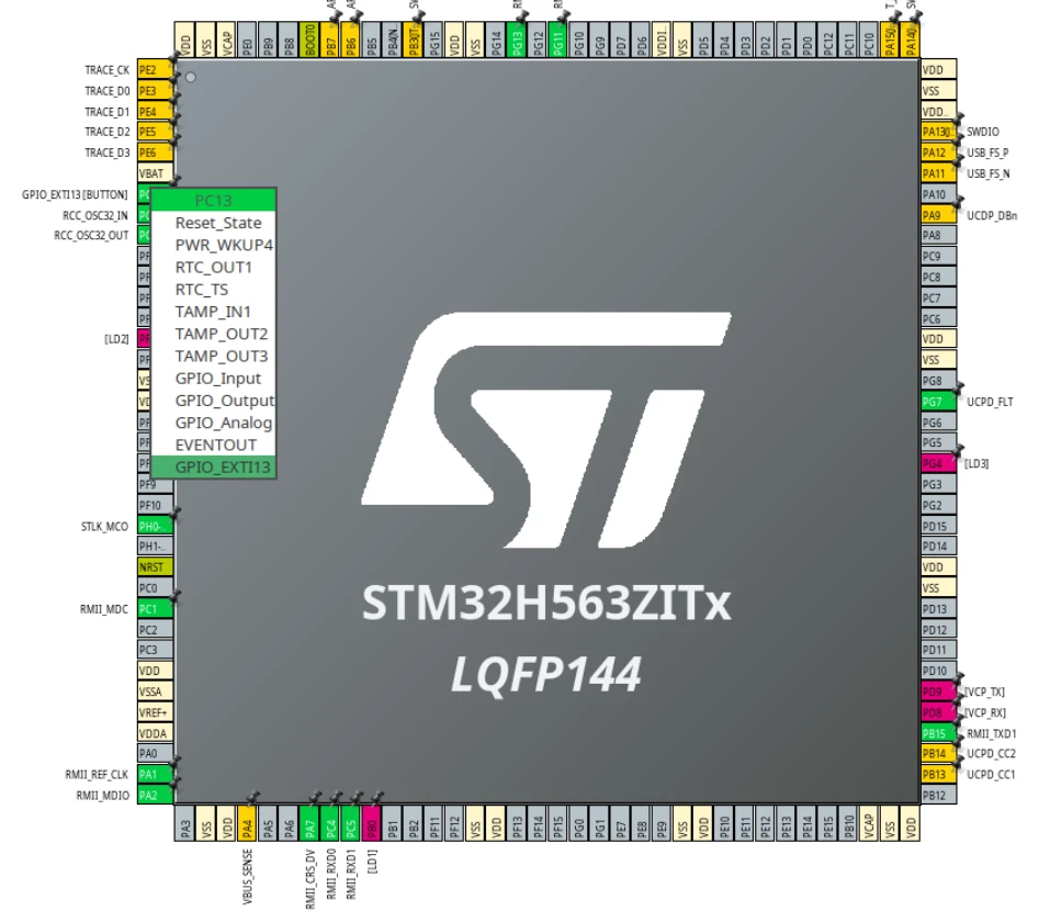

and this is how i setup the controller:
I tried what's shown in the figure, i was expecting the execution to continue after pressing the button. If it worked i would have start to work on the Ethernet wake up.

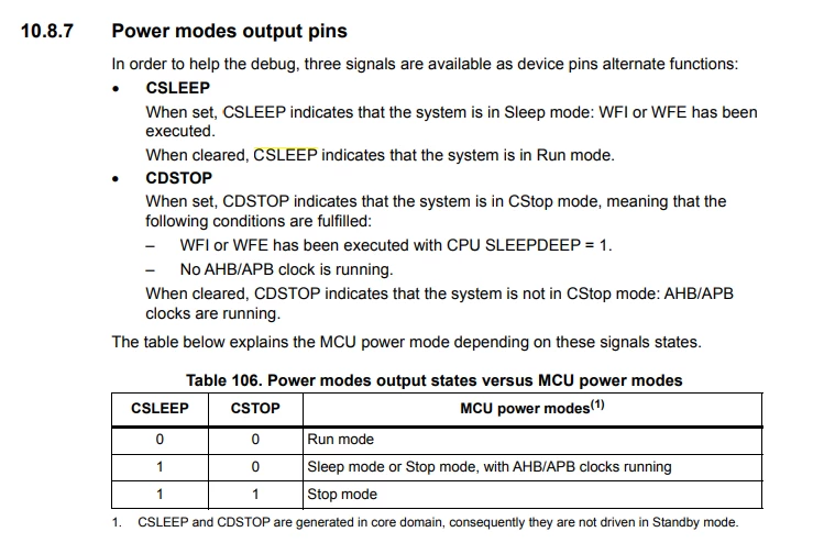

another Tips in trying to visualize the signals CSLEEP and CSTOP pins to know the state of your device and if it really entered a stop mode.
here is the snippet describing the state of this pins from STM32H523/33xx, STM32H562/63xx, and STM32H573xx Arm<Sup>®</Sup>-based 32-bit MCUs - Reference manual

try implementing the steps as described and as found in the example and give us the status of CSLEEP and CSTOP pins if it is not working as expected.
know on what is happening the behavior is not clear so we need to get results after following those steps to be able to analyze it would help if you can share you code to have a look at it.
