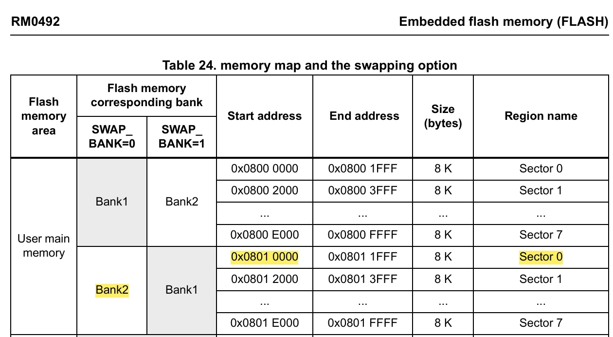

I am trying to erase a sector of the flash memory on my STM32H503RB.  I have successfully validated that I can write to the flash, but when I attempt to erase the sector that I wrote, the contents that I wrote stay the same.  I have a feeling that I am just erasing the wrong sector, but I can't seem to find where I went wrong.  I'm pretty sure that I can erase, because if I put in a deliberately wrong sector number (sector 4, which corresponds to the location of the LL drivers) the device hard faults (which is what you expect when you erase the drivers).
I am trying to erase the sector starting at 0x0801_0000, which I would expect to be sector 8. (sectors are 8 kiB, correct?)  I have tried erasing sector 8 of bank 1, sector 8 of bank 2, and sector 0 of bank 2, but none of these seem to work.  Am I misinterpreting how the banks and sectors interact?

> uint32_t addr = 0x08010000;
Try erasing sector 0 of bank 2. Also ensure banks are not swapped.
Try the same thing with STM32CubeProgrammer to see if it you get success there.

I'm not sure what I did the first time I tried Bank 2 Sector 0, but it seems to have worked this time.
