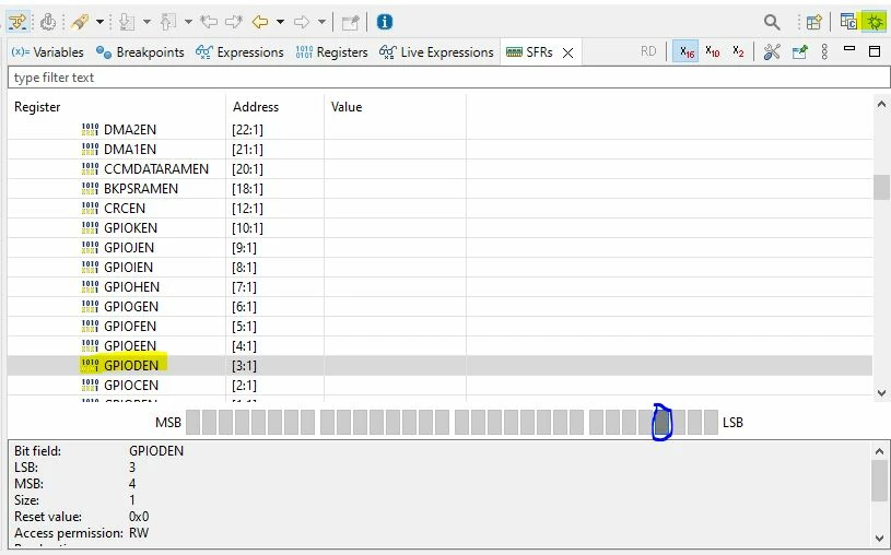

Hello everyone
I have a little problem with stm32cubdeide, when im trying to work in debug mode with the mcu stm32f469nih6 i can't modiffy or add any bit to enable the register RCC->AHB1NER->GPIODEN.
I just want to set clock to activate other peripheriphal and blink any led
0693W00000Y6wDLQAZ.jpgshows a little blue circle where should be modify and put 1 to activate, but i cant add etiher 1 or other number, i dont know what is the solution, any can help me? please
Regards

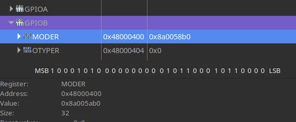

here it looks like:
0693W00000Y6wY4QAJ.pngat your pic - no bits shown , so maybe the port is not enabled at all .
you cannot change anything , it needs to be possible by your init/setup code ;
if register bits are shown,just click on it to toggle state. if greyed out - impossible.

Click on Pause button if you didn't do that already.

i solved the problem my card was not detected by stm32cubeide due to a problem with the dll driver and therefore did not allow me to work in debug mode, I solved the connection problem and now I can add or modify records in debug mode.
