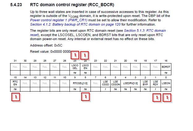

luuuuuuu1
luuuuuuu1Author
April 22, 2022
The RCC_BDCR register is configured as follows:
waclawek.jan
waclawek.janBest answer
April 22, 2022
luuuuuuu1
luuuuuuu1Author
April 22, 2022

waclawek.jan
April 25, 2022
> RCC_BDCR |= 0x100U;
I am not sure what are you trying to achieve by this.
Make sure some of the symbols you use to write into RCC_BDCR does not contain also the RCC_BDCR.BDRST bit. Single-step in disasm to see what exactly gets written into RCC_BDCR.
Do you observe (using debugger) the registers loss before the above code is called?
Write a simple test code manipulating only the backup register, without any other "framework" whatsoever. Still problems?
Also, tell us about your hardware - in particular, how is VBAT connected?
