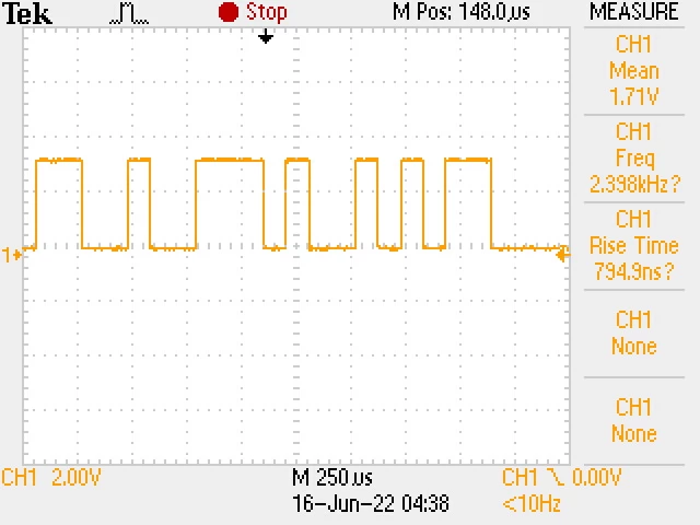

I can "tap into" the ESP32 TX pin and connect this to a USB serial port RX pin and see the data while it boots, but the STM32 simply does not see it. I've look at the data on the scope, and logic levels are correct.
