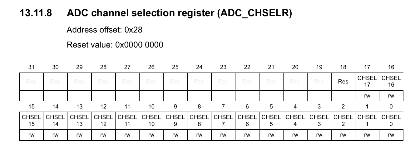

I want to measure ADC on multiple pins. I don't need DMA, just measure PA0 then measure PA2. Measuring PA0 works, but when I switch the channel to 2 it still measures from PA0:

Without DMA, you can only convert one channel at a time. When you reconfigure for channel 2, you need to disable channel 0.
Easiest way would be to modify CHSELR directly to have a 1 in the bit you want to convert and 0 everywhere else.

I only need to measure 1 channel at a time, so this is what I used and it works now:
CLEAR_BIT(ADC1->CR, ADC_CR_ADEN);
ADC1->CHSELR = ADC_CHSELR_CHSEL2;
SET_BIT(ADC1->CR, ADC_CR_ADEN);
