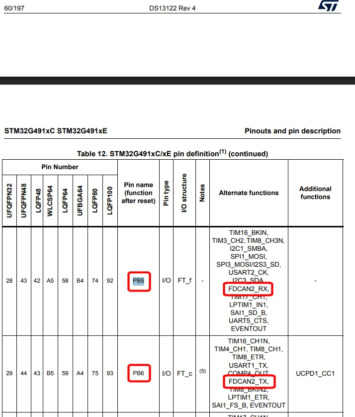

Hii Team, I want know does PB5 and PB6 Support CAN interface on the STM32G4A1KEU6 AND STM32G491

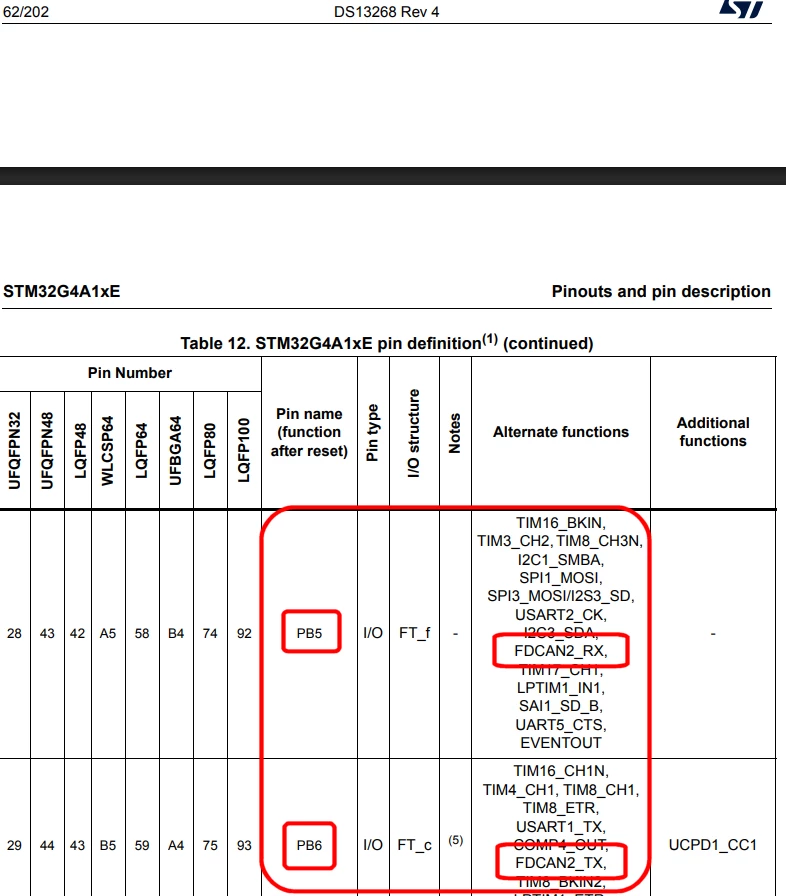

the STM32G4A1KEU6 datasheet shows that FDCAN is supported on PB5 and PB6:
As does the STM32G491 datasheet:
You're going to have to give more details for anyone to be able to help with why your project isn't working - see:

I am using PB6 and PB5 for project as fdcan2 but i am not getting any data  .In the datasheet for PB5 and PB6 they had mentioned FDCAN2
