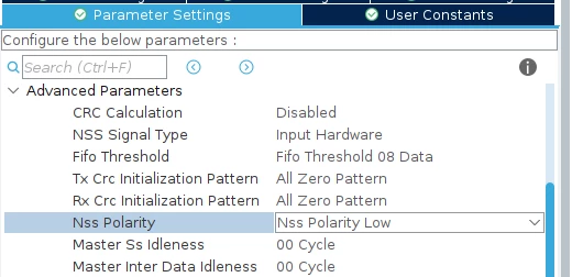

!!!!! UPDATE !!!!!
So the CPOL & CPHA on both master SPI devices that I'm working with are the same (1 & 1), but for some reason the new master device has an ACTIVE HIGH chip select, whereas I am used to the standard active low default.
So now my question becomes:
How do I update my MxCube settings to accept an Active High chip select?
AScha.3
December 9, 2022
just set nss pol. hi ->
0693W00000WKeljQAD.pngor, if you cannot nns hardware pol. , put just a simple inverting gate in the line to cpu nss and is "low" select again.

Changing the NSS polarity isn't an option on this device apparently. I'll have to figure out how to invert the signal before it hits the MCU. Thanks for the help!
