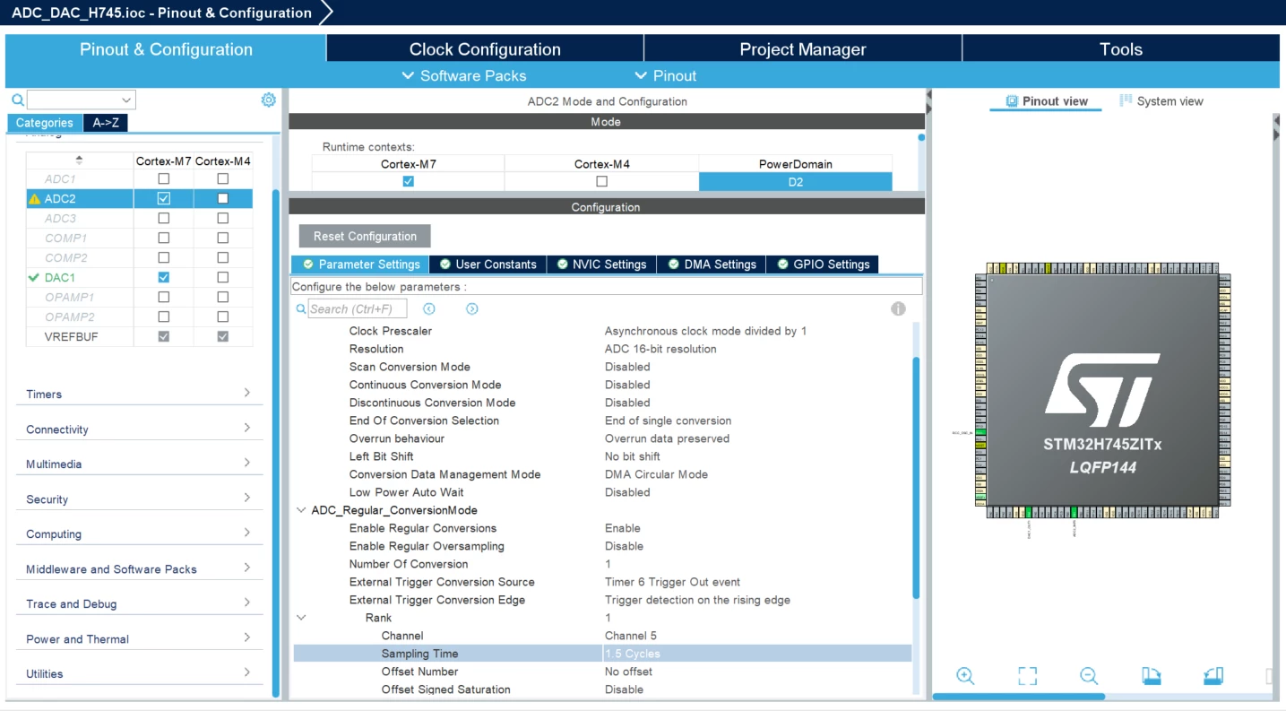

Hi Team,
I am working on a project using the STM32H745 microcontroller, and I need to sample a 500 kHz sine wave using the ADC. I have configured the ADC with the following settings:

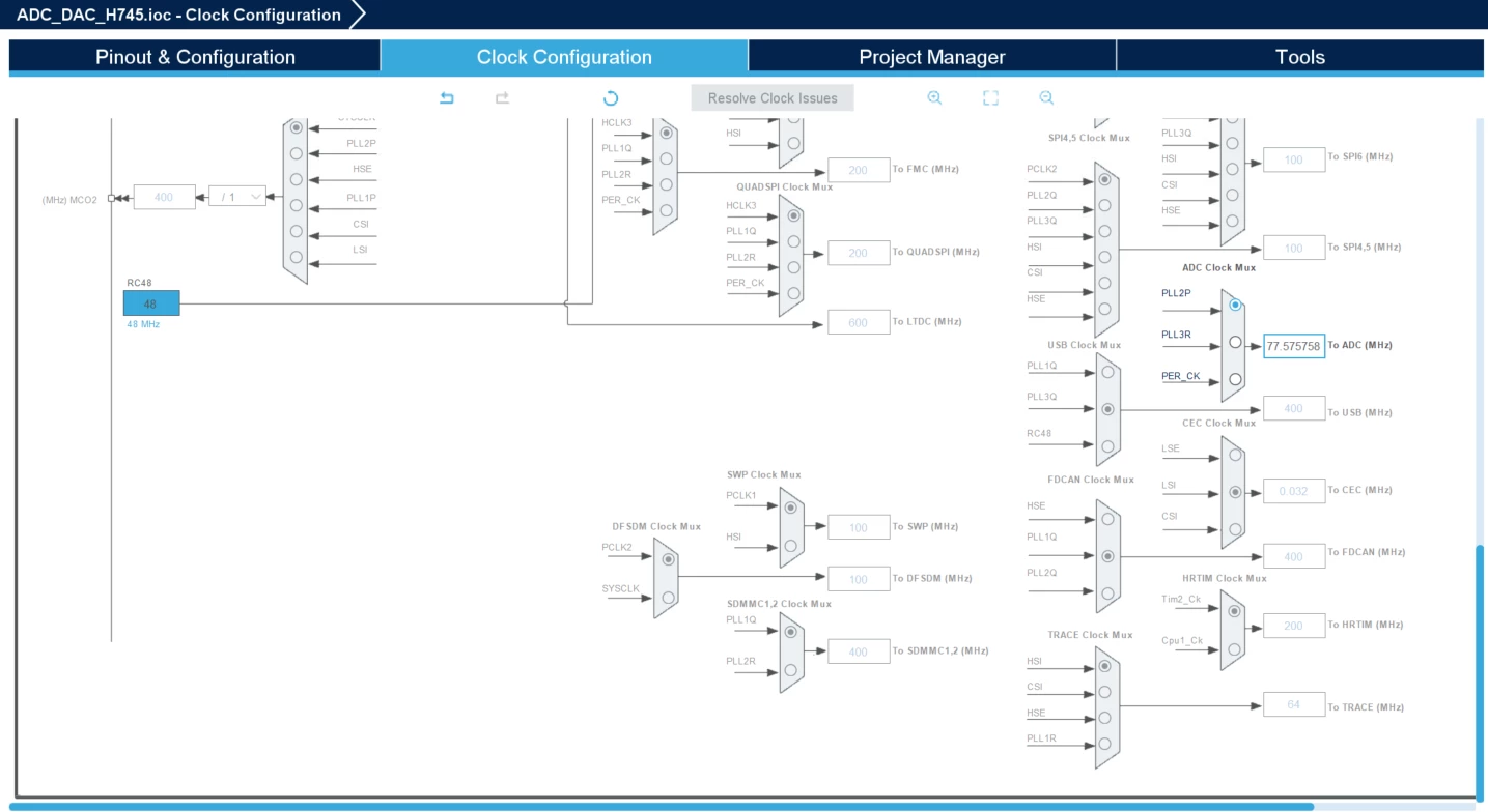

  • ADC clock: 77MHz
  • Resolution: 16 bits
  • Sampling time: 1.5 ADC clock cycles
  • Continuous conversion mode with DMA enabled(32bit)
  • Sampling Frequency Timmer : 1MHz

ggowd.1
ggowd.1Author
May 14, 2025
Hi @AScha.3
Thank you for your feedback.
  1. ADC Clock : Reduced from 80 MHz to 50 MHz to comply with the STM32H745 limits. This achieves a sampling frequency of ~3.45 Msps (12-bit resolution, 2.5 cycles sampling time).
  2. External Buffer : Added a TLV3501 op-amp as a low-impedance buffer to condition the input signal and reduce distortion.
Best Regards,
Gagan Gowda
