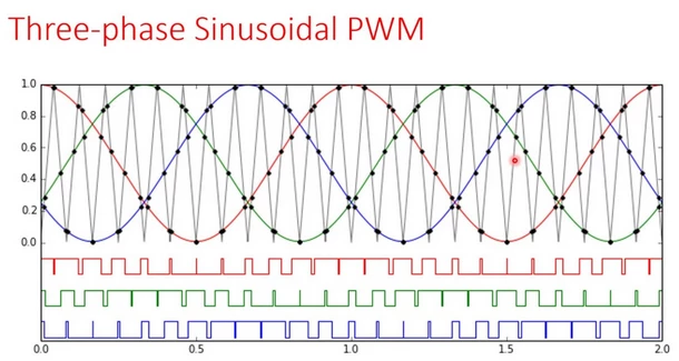

I need to be able to control two three-phase inverters with SPWM modulation, for which I think STM32H743 is the microcontroller I need. It has (as many others) advanced control timers TIM1 and TIM8, but I have a doubt about them:
Can each of them generate THREE PWM signals phase-shifted 120º modulated by SPWM, PLUS THREE complementary, for a total of 6? (For example, TIM1_CH1, TIM1_CH1N, TIM2_CH2, TIM1_CH2N, TIM1_CH3, TIM1_CH3N). And same with TIM8 for another 6?
As far as I understood, each timer can only generate ONE pulsed signal in all of its channels AND its complementary on its CHX_N channels.

Yvo
YvoAuthor
Mar 16, 2021 6:24 PM UTC
Hi, all
@Community member​ , with SPWM I mean Sine-Pulsed Width Modulation (https://ieeexplore.ieee.org/abstract/document/5489272), the kind of modulation which varies its duty ratio following a sinusoidal function and which is the result of compairing an up-down carrier with a sinusoidal signal. If the same carrier is compared with three sinusoidals phase-shifted 120º, the result is a three-phase SPWM able to control a 3-phase power converter. The signals are presented in the following picture:
0693W000008x5FfQAI.pngI've found out that TIM1 and TIM8 are suitable exactly for that kind of modulation, since the counter does the carrier shape, and the comparators of each channel CCR1, CCR2 and CCR3 can be a sinusoidal function with an arbitrary amplitude and frequency.

waclawek.jan
Mar 16, 2021 11:54 PM UTC
OK so you basically want to use the PWM as a form of DAC. This does not require phase-shifted PWM pulses, then, unless I am missing something.
Precalculate the required values for CCRx for each period, put them into a table, and fill them into CCRx using DMA and the TIMx_DMAR mechanism. There should be an example for this in the examples in CubeH7, try to look there.
