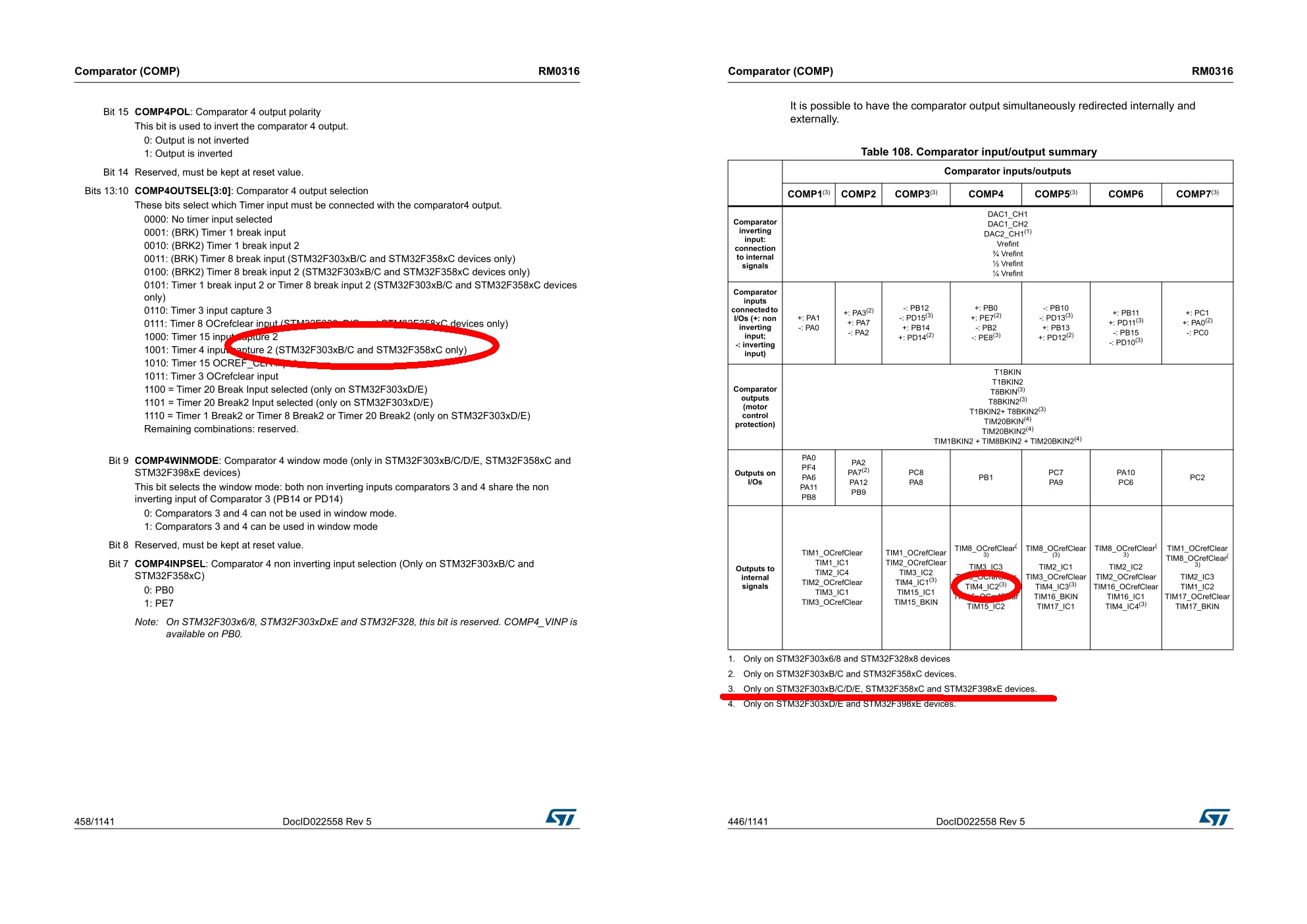

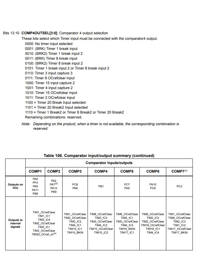

waclawek.jan
Jul 19, 2020 5:47 PM UTC
Maybe TIM2_CH4 is unavailable in the 'F303xE. The 'F3 OPAMP and COMP chapters are full of errors.
@Imen DAHMEN​ , can this please be clarified?
Thanks,
PS. AN4651 is not helpful, it appears to be a verbatim copy of the interconnections chapter which is not helpful either, as the exclusions are not detailed in the COMP-to-TIM table at all.
Jul 20, 2020 10:11 AM UTC
Regarding the RM0316, the contradiction notes have been removed on the latest RM Rev8.
Best Regards,
Imen

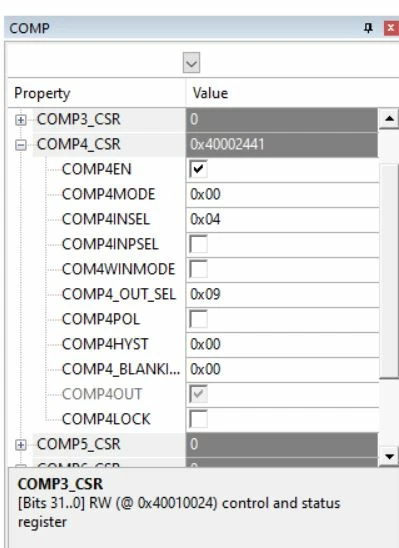

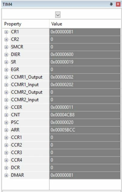

Jul 20, 2020 7:58 PM UTC
Hi ,
I'm attaching snapshots of COMP4 Reg and TIM4 Reg,0693W000001tEfMQAU.jpg 0693W000001tEflQAE.jpg
waclawek.jan
Jul 20, 2020 10:14 PM UTC
This all looks reasonable, the channels' crossing is a bit weird but that's probably the experiment you've described in your initial post.
Also, you have DMA enabled on both CC1 and CC2, why's that? Is there any difference if you don't enable that DMA?
Please double-check in GPIO registers that you don't have any TIM4_CH2 input enabled in the GPIO matrix (PA12, PB7, PD13 - please check GPIOD even if that pin is not present on your package).

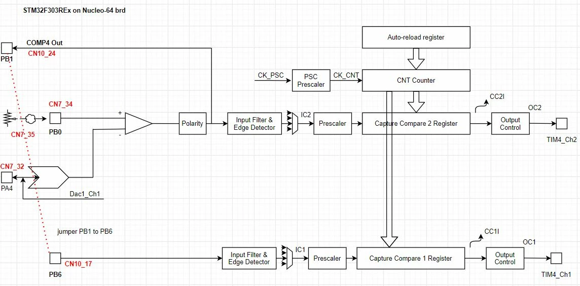

BTrem.1
BTrem.1Author
Senior
Jul 23, 2020 11:32 PM UTC
0693W000001tU1DQAU.jpgThat's the strange thing; no code change. The COMP4 output is always present on PB1. With no input on PB6 (TIM4_Ch1) both TIM4_CH1 and TIM4_Ch2 do not run. Then I connect a jumper wire (real-time) from PB1 to PB6. When I do this both TIM4 CCR1 and CCR2 start capturing.
I'll go through the pin out of the Nucleo-64 F303RE again and also matrix connection for PB1 & PB6 going to TIM4_Ch1 and TIM4_Ch2.
I'm attaching an updated block diagram adding TIM4_Ch1 and showing the jumper wire. Also, FYI, when I do this both dma channels start running.
