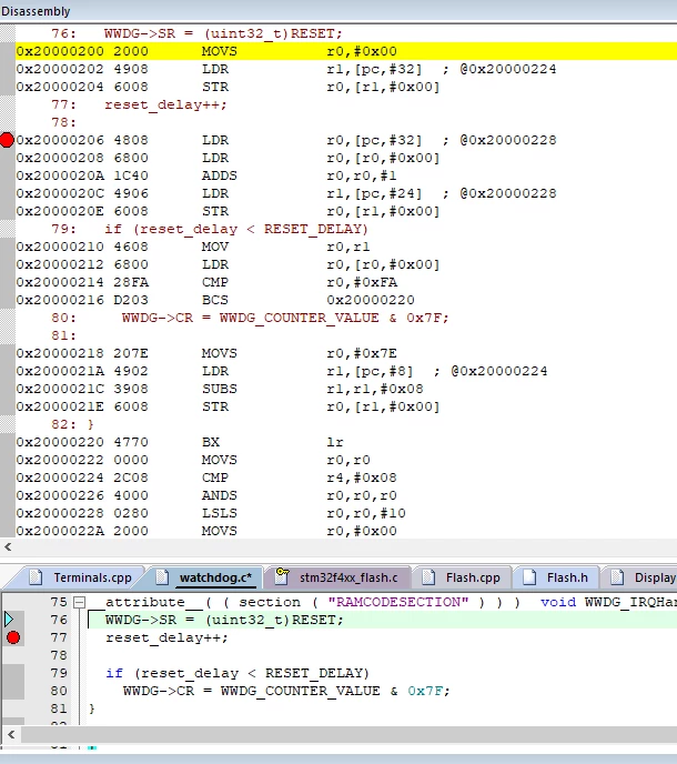

i'm dealing with the window watchdog.
as my program erases a sector in flash i created a watchdog irq handler in RAM which retriggers the watchdog wen the sector is erased.
my Watchdog irq has the highest priority. all other irqs have lower priority
NVIC_InitStructure.NVIC_IRQChannel=WWDG_IRQn;
 NVIC_InitStructure.NVIC_IRQChannelPreemptionPriority=0x00;
 NVIC_InitStructure.NVIC_IRQChannelSubPriority=0x00;
 NVIC_InitStructure.NVIC_IRQChannelCmd=ENABLE;
 NVIC_Init(&NVIC_InitStructure);
0693W000004KV1BQAW.pngAs far as i can tell my watchdog irq runs completly from RAM.
I ran some tests (don't trigger the watchdog from my mainloop) and i jump into the irq handler and can extend my watchdog window. so i think in principal this code works and the movment to RAM was successful.
but as soon as i start to erase a sector the watchdog retriggering does not work and i run into the watchdog reset.
there can happen other irqs with lower priority whichshould be stalled as they are not run from RAM.
Should my watchdog RAM handler be able to interrupt these stalled IRQs(this was my expactation) or do i have to disable ALL other IRQs which do run from Flash as stalled IRQs are not interruptable?

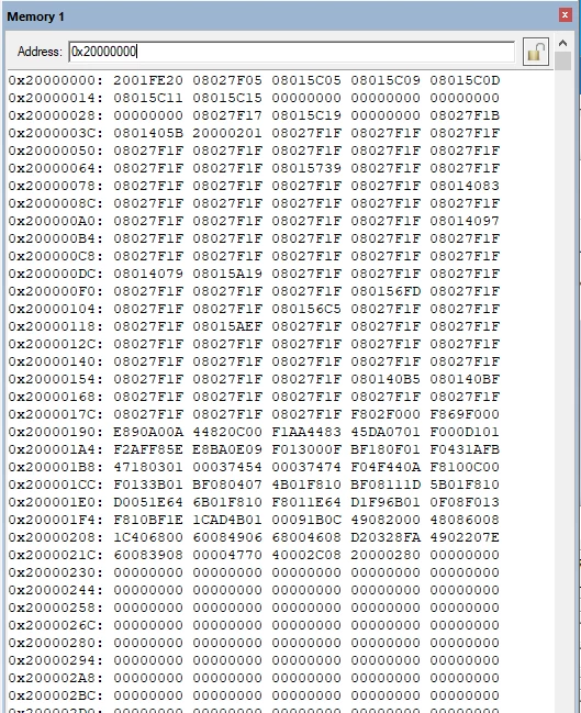

this is my interrupt vector table and as far as i can tell the wwdg handler points to a RAM location(the 0x20000201 address)0693W000004KVEeQAO.png
memcpy((void*)0x20000000,(void const*)(FLASH_BASE | VECT_TAB_OFFSET), 0x1FF); // Move Vector Table from FLASH to RAM
 SCB->VTOR = SRAM_BASE ; /* Vector Table Relocation in Internal SRAM */
